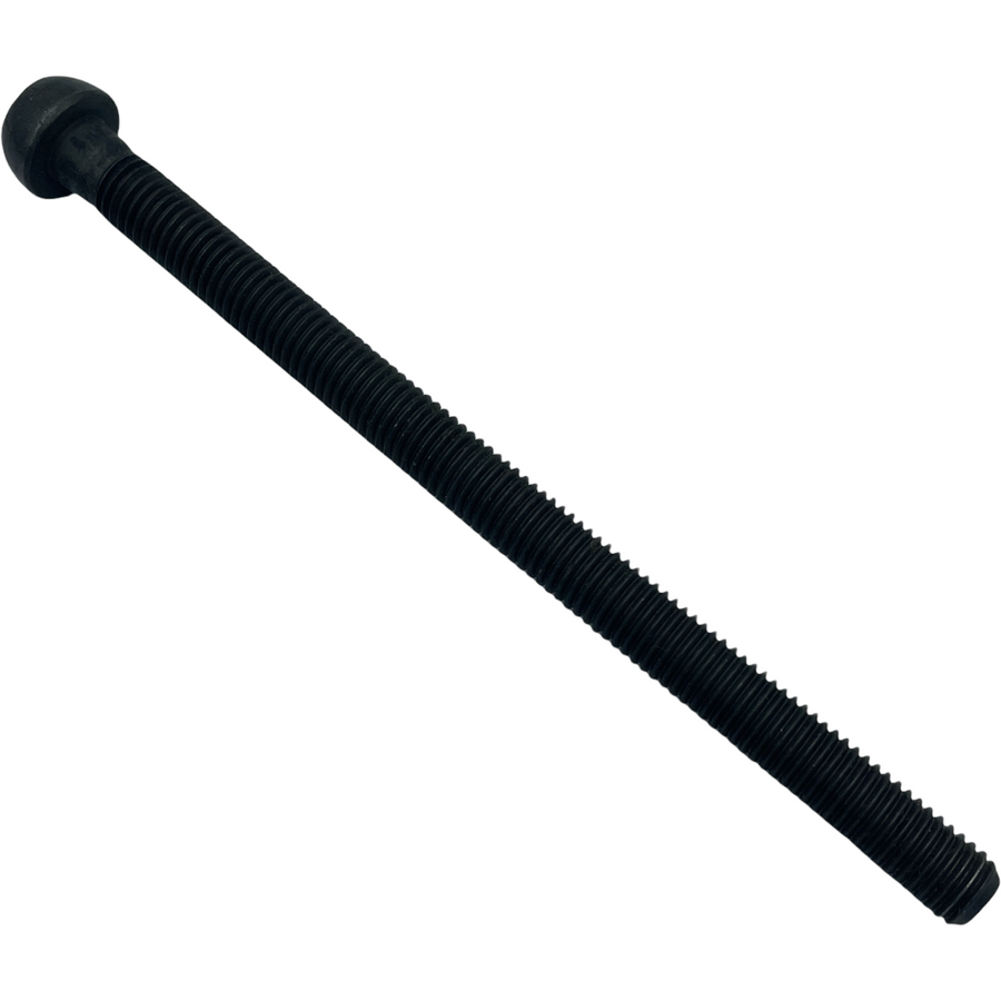

Most important first, I'll be going into the engine to change some things and instead of using new k100 head bolts to button it back up, any issues using the K1100 head bolts if shortened?  I'm mainly on about the different profile in regards to what kpartsholland has on offer...
K100
Vs
K1100
From what I've seen around the web, from about 93 is when the head bolts went from that K100 profile to the nearly full length thread in the second pic.  Dunno if that's anything to do with the K100 ending but I'd imagine so...
I'm a machinist by trade and shortening the bolt with negligible heat is doable, and I've shortened head bolts before with no issues, but as I'm new to this engine are their any concerns?  Oil galleries?
The K100 bolts are nearly twice the price, and I don't mind paying if I have to, but I'll save money if possible.

In regards to the head bolt question, I'm going to give it a go regardless, same thread pitch and the threads where the shank is on the k100 bolt isn't restricting anything from what I've been able to find.
Will post back here next year and after about 100 miles with compression figures after it's all finished.  :wink:  Thanks for looking

Why are you getting head bolts, are you replacing the head gasket? I'm assuming that the engine hasn't been cooked. Another option is to use the existing bolts. Lots of people have used the original bolts again without problems, including torque to yield bolts. If the longest head bolt isn't any longer than say 0.2mm of the shortest bolt, I will guess that you can use the existing ones. Let's say one of them does come loose, one of the good things about bricks is that it's pretty easy to get access to the head bolts, to replace them. That's a bonus, whichever way you choose to go. For this reason I think it's also worth trying to adapt K1100 bolts to suit.
How did you shorten the bolts previously?

I scoped the cylinders and compression was fine, didn't notice any scoring but IF I flip the coin and elect to go into it I will be replacing the pistons with K75 tops and new rings.  I've always used new when it comes to head bolts that weren't ARP, just a thing I've done since my first engine and I don't mind in this case.  It's a mixed bag from what I've read in regards to some snapping on the way out but loads of others reusing theirs with no issues whatsoever, so I just want to go ahead and do new on the first, and hopefully only, rebuild.
Last time I shortened head bolts I used an Okuma Genos L-400.
As this is my first K, I've no experience with the subtleties and niggly bits when it comes to their engines... yet... but I'll get there.  Will measure the depth of the hole if/when I actually get in there and see if shortening is necessary.  Would be nice to find out for sure though and share the results here so people aren't pigeon-holed into buying only K100 head bolts at 11-12 quid a pop.
