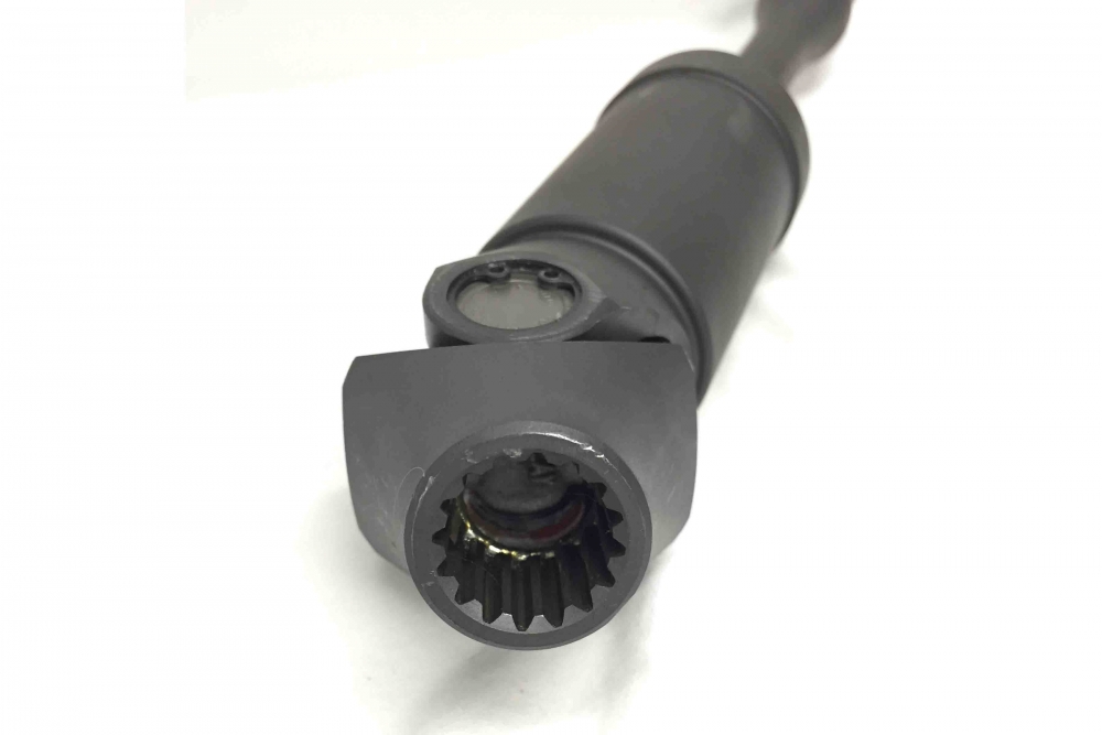

Hello I’m piggybacking onto this spline forum to get more opinions on my bikes splines. It has 84,000 mi on it and hasn’t been ridden in 10 years before I bought it. When I opened them up there was grease! The splines look decent to me just checking with you all to make sure.

« Reply #11 on: September 25, 2023, 01:07:42 PM »
Those splines seem severely worn to me, judging by their sawtooth appearance. A closer, straight-on photo with good lighting would help in judging them. As they appear right now, you could possibly get a few thousand more miles from them if you don't flog the Brick when riding. When the tips become too narrow, they'll break off, the driveshaft will make an unpleasant ratcheting noise, and forward motion will cease.

Here’s a better photo

« Reply #13 on: September 25, 2023, 02:39:41 PM »
Good photo, Andre!
I stand by my original assessment; you have a few thousand more miles left if your clutch control is smooth and you aren't whacking the throttle.
You have options while you're still riding. Motobins in England sells a replacement socket that can be welded into place.
Ted Porter has a replacement driveshaft for ≈$200 less than the original BMW part that is available.
OEM
Decent driveshafts occasionally turn up on eBay, just don't buy one with sawtooth profiles on the splines.
