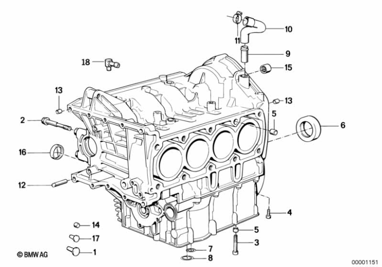

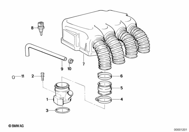

There should be 2 small lines that connect to the air box.
1 line connects to the bottom of the cyclonic oil separator that is an integral part of the top lid of the air cleaner, and is supposed to drain the separated oil back to the crankcase. #9 in 1st image.
The other line is from the vent at the back of the crankcase #10 in 2nd image.
