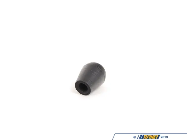

The three little black rubber caps on the throttle bodies should probably be replaced too as those dry out and crack with age. The BMW part is 13547694924 but any cap that size will work.
