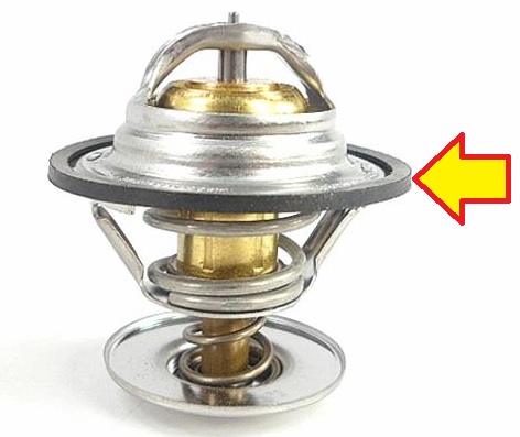

If you plan to mess with the thermostat to remove or inspect then be very careful with the gasket around it. It is fragile and not available as separate part. You need to buy an entire new thermostat to replace it.
https://shop.maxbmw.com/fiche/PartsSearch.aspx?&searchtype=undefined&parts=17111460716%0A%0A

Somebody, somewhere here, posted that replacement thermostat of same dimensions is available for a Ford Fiesta or something similar? I can't find the reference.
https://www.motobrick.com/index.php?topic=4903.msg30736#msg30736
The thermostat's rubber gasket is too large for the K75 so a BMW replacement needs to be procured.  See the discussion in this thread:
https://www.k100-forum.com/t7589-thermostat-gasket-not-o-ring
