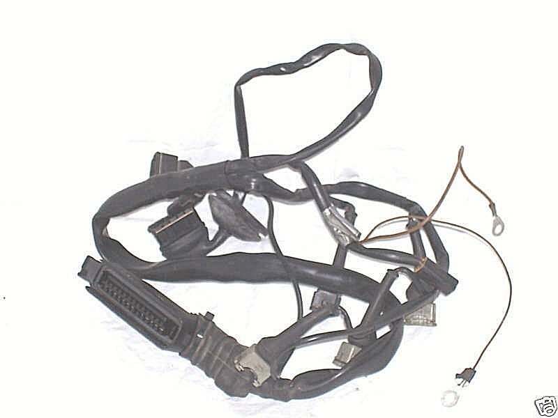

The only plug for the TPS is the one that plugs into the TPS.  It's part of the engine wiring harness that plugs into the L-Jetronic.
Foilow the wires from the ignition switch to find its connector. It has four wires: Red,  green, gray & gray/blue.
