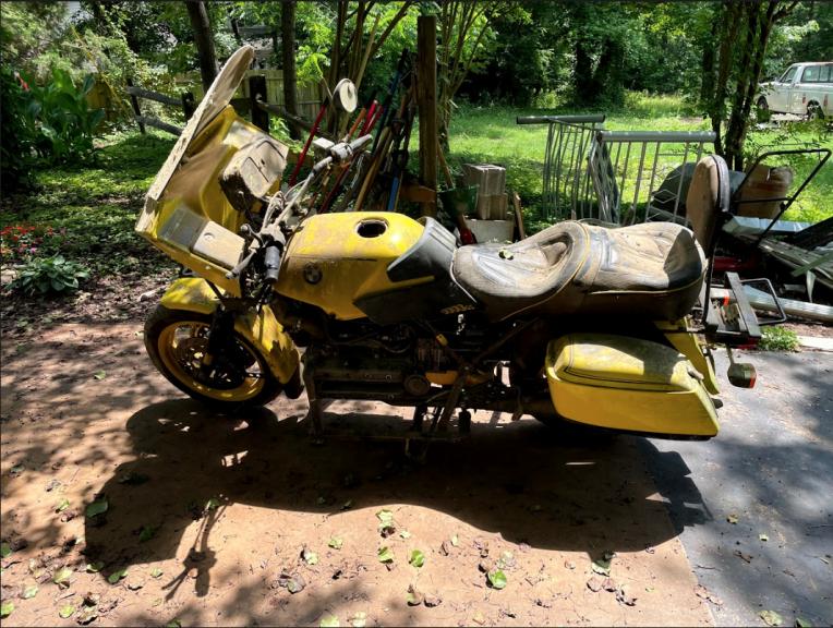

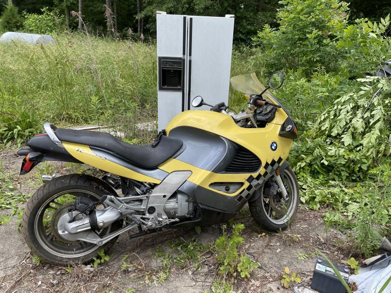

1998 k1200rs - (checkerboard)
* IMG_0071.JPG (134.3 kB . 768x576 - viewed 720 times)
This bike was a barn find (as was all of the biked) and it had vines growing up and through the instrument cluster.  That was the first thing I removed... fairing and inst cluster to get the hard 1/2" vines out of the fork/instruments/windshield.  I was successful and didnt damage any wires.
The fuel system was another story.  There was gas left in the tank... and after removing the "sending unit??" and the pump/filter assembly and the filler cap, I found corrosion on fixtures, gelly/shellac gas in tank, and messed up fuel pump.
I removed battery, and all fairing.  The fairing has three small cracks on the right hand side front, and one crack on left.  each crack four inches. The rest of the bike looks mechanically sound.  I have not pulled throttle body/air stuff, but that was my next step.
I would love to be able to get a new fuel pump assembly filter and stuff and have tank cleaned out.  I would like to keep this bike if it is possible to fix/clean it up and not have it cost a fortune.

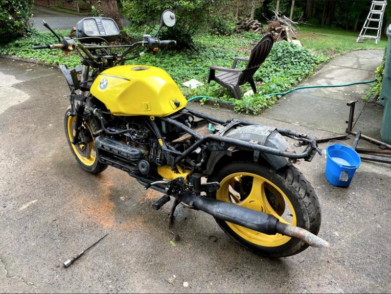

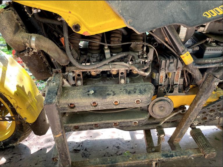

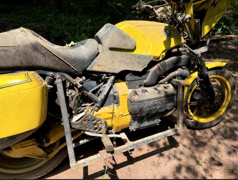

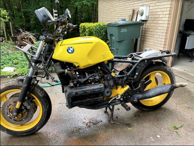

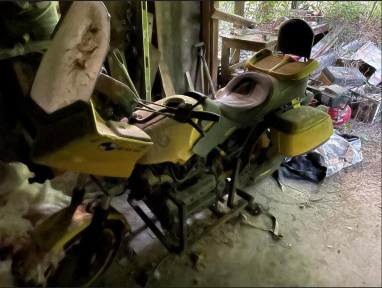

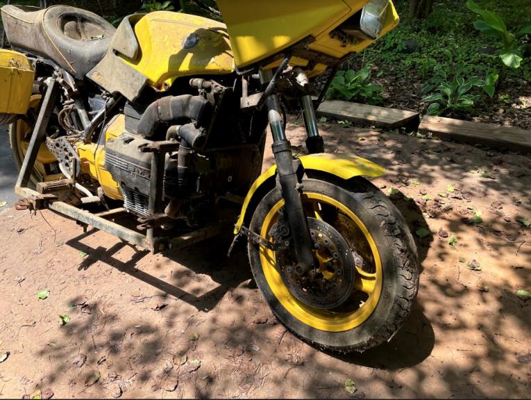

1990 K1 - don't get excited... it does not have any of the original fairing.  The previous owner built a custom fairing and fenders... and possibly never finished the project.  I found this forum by searching K1 cafe racer and found an old post with a good conversion....that was what I was thinking about turning this into.   That being said, this bike may possibly  be the hardest to work on because of what it needs.  The ECM is just sitting in the battery box, the reservoir tank is there too, there are a bunch of wiring stuff just hanging out and that looks like scary spaghetti.  Mechanically is it all there... look at the pics. It would make a cool cafe bike, because there is NO WAY im going to pay for the original fairing.  Look at pics.

For this bike I think I would love to either convert it to a cafe bike or sell it outright to someone.

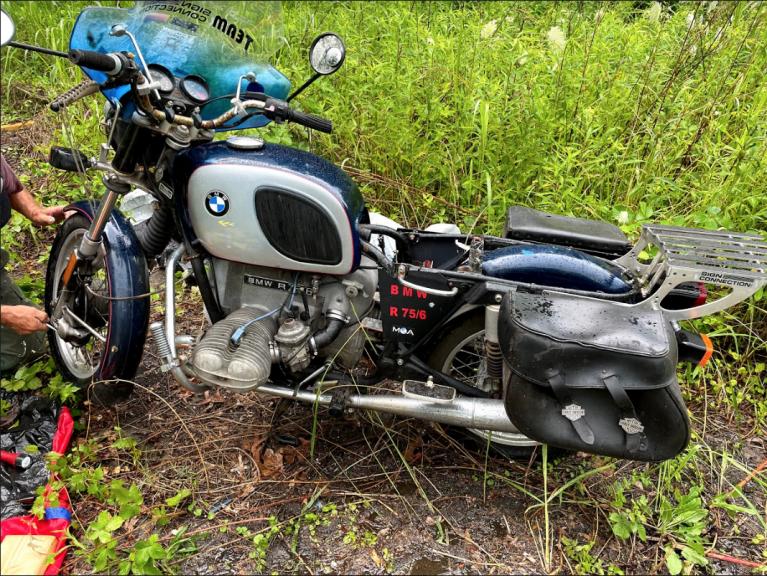

1976 r75/6 - mechanically good, no shellac in carbs or tank. Turns over, but master cylinder was frozen and I need a rebuild kit, as with caliper and rear shoes.  I need a brake hose.  This bike is not the coolest, but it is SOOOO easy to work on. needs tires, battery,  brake hoses, and brake cable.  Probably a condensor and air filter.  It does have the seat.  It was just removed in this pic.
* Screen Shot 2021-07-07 at 9.26.31 PM.png (141.49 kB . 767x576 - viewed 690 times)
I would like to fix this for my dad, so probably planning on keeping unless i can move it quickly without having to fix it up.

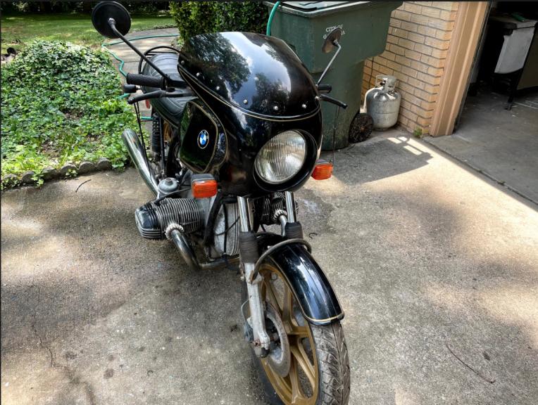

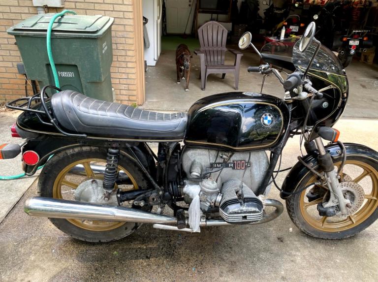

1977 r100s.  This is the best looking bike I have.  The master cylinder needs rebuilt as do the calipers.  There WAS rust in the tank , and when I mean rust, I mean I can shake the tank like a rainstick.
The carbs are fine, the valves are fine, the master cylinder is not pitted or scored.  needs tires, hoses for brakes, pads, brake cable, battery.
* Screen Shot 2021-07-07 at 9.27.10 PM.png (97.66 kB . 768x573 - viewed 679 times)
* Screen Shot 2021-07-07 at 9.26.43 PM.png (103.07 kB . 764x576 - viewed 680 times)
* Screen Shot 2021-07-07 at 9.27.10 PM.png (97.66 kB . 768x573 - viewed 686 times)
Because this is the bike in the best condition, I was thinking that I could restore this and keep/'sell it because it was of a higher value.  I dont know.  I do know that I do not want to chop this airhead up for parts... I have most of the original parts.

Re the K1, the custom frame in the pics looks like a sidecar attachment.  You might look in the barn for the rest of the build.

That's what I'd do, too. If you cleaned up the aluminum components and frame on that R100S, replaced the points and condenser with a Dynatek DynaIII electronic ignition, replaced fuel hoses and other rubber components, overhauled the petcock if necessary, completed the brake overhaul, got a stock instrument assembly and found stock battery covers, it could be a $6000–$10,000 ride you're on when in my neighborhood. That isn't a typical R100S handlebar but a flatter one is available from Flanders.

One thing you should know about the K1 is that is has the turning radius of a Mac truck. (I think BMW did that so that the handlebar mirrors wouldn't hit the K1 fairing.)  If you want to cafe it then you'll probably want to trim down the nubs on the front of the steering head to deal with that.

The K1200 doesn't look too bad. I wouldn't be parting with that just yet....assuming you want to ride it. The reviews are favourable for that powerful beast.
