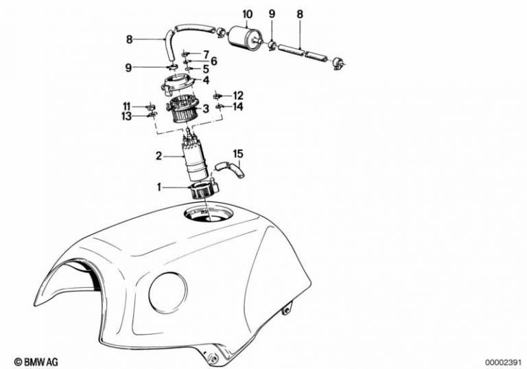

A small pool of fuel was on the floor underneath the RT this morning.
The heat shield padding to the rear half of the tank is soaked with gas which I guessing from there ran down the side of the engine to the ground, I see no active or visible leak with lifting the tank.  I'm spit-balling here.  We had extreme cold a few weeks ago, -6 F at my house in East Texas, temps now well above that (30's-70's).  I'm reasoning something (plastic?) has cracked around the base of the fuel pump mount underneath the tank and is seeping fuel which the heat shield pad soaked up like a sponge and then dripped (?)
I'm trying to remove the tank but having trouble getting the rear fuel hose to release from the tank pipes.  I'm sure the rubber had adhered to the metal pipe.  I'm waiting for it to warm up more and try it then.  If no luck I'll slice the fuel line and replace it.
This schematic is from Bob's BMW.  The part #1 is listed as a fuel filter (?), I'm thinking it's a mount to the fuel pump attaching to the bottom of the tank, maybe the source of the leak?  Any opinions welcome.

Heat the hose with a hair dryer then rotate it back and forth with pliers; otherwise, split it then peel it off.
The most likely reason for fuel tank leakage is corrosion along the tank seams along the bottom of the tank (green arrows) or a faulty o-ring at the fuel level sender cover (red arrow). Also, external fuel hoses can rot then leak and their clamps can loosen.

I've checked the seams, no corrosion or leaks seen.  The drip is directly underneath the fuel sender cover (thanks for the photo).  The heat shielding is soaked where it's around the cover and then to the back of tank.  I'm guessing the o-ring has failed and needs replacement.  From Bob's schematic I'm fairly sure I need part #11

Break out the visine and coffee there, MC. #8 is a fuel line in your diagram.  :laughing4-giggles: #8 is tank insulation in your upper diagram.
It's #11 in this diagram.
