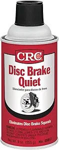

I've changed lots of K brake pads. Not once have I done it with a caliper bolted to the fork.
Just spray disc brake quiet on the backs of the pads to mitigate brake squeal.

You can just drill out the holes in the brake pads to make them fit better. I've done that with aftermarket pads where the holes didn't line up perfectly.
EBC pads have the wire clips. I still use disc brake quiet on those too. It can't hurt.
