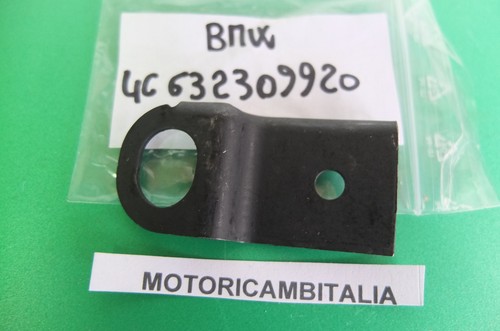

02    46 63 2 309 919    BRACKET LEFT 0.04 1 $6.85
02    46 63 2 309 920    BRACKET RIGHT 0.04 1 $6.85
From here:

I noticed UK's Motorworks sell just the left-side bracket, while right-side one is not offered anymore.
But to me they look identical - can the left-side bracket (with some adjustment) be used on the right side???
1997-1999 R 100 RT, 1999-2000 R 100, 2000-2003 R 80, 2003-2017 K 100 LT; now K 1100 RS

If the price is cheap enough get 2 and let us know.....  :dunno2:
I think they are the same, unlike the bag clips that are directional.

I found them both at of Italian eBay shop "Motoricambi" (motorcycle spare parts). The edges are bent differently on left and right one - like viewed in the mirror. But I guess if that edge on the left one would be removed with an electric grind tool it could be used on the right side - and vice versa. If tightened well, I guess they would not turn even if that edge is not present
