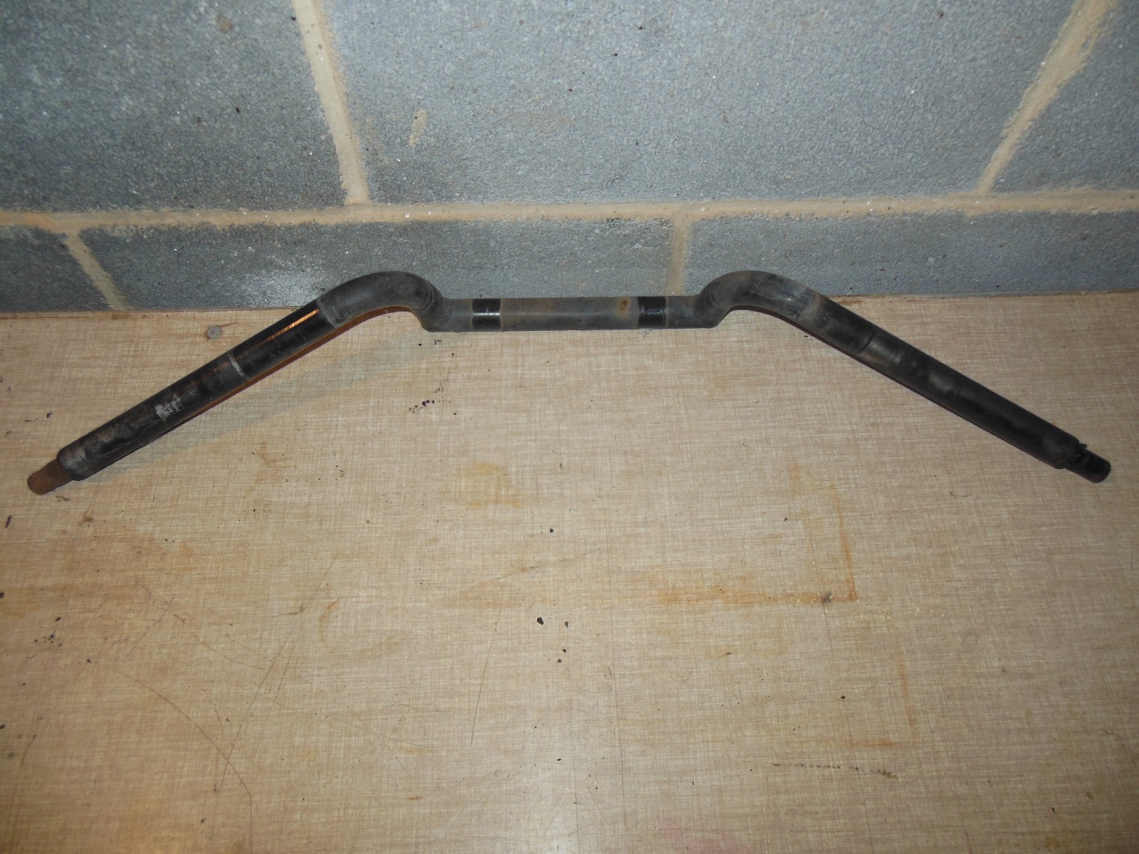

Then when I put them on the bike I discovered that they were not really K100RS bars as they were quite a bit wider than the correct bars.  They also have a slightly different bend that doesn't line up correctly with the dash pad.  Not a big deal I thought, I'll just shorten them, but the bend doesn't allow the perches to be slid down the bar all the way to the ends of the pad.  Looks like I will have to live with a 3/8" gap between the perches and the pad.  I have the left end done, will have to do the throttle end this weekend.
Do you need some RS bars? I believe they're from a K1100RS. I bought these and I'm not going to use them. Not sure if they will work for you but here they are:
  • Henderson, NV
  • 1985 K100RT
  • Posts: 6856
Re: The Resurrection of Moby Brick
« Reply #65 on: February 16, 2018, 04:28:45 PM »
Crap!  If I had seen those a month ago it would have saved me at least two days of screwing around.  Got the ones I had working pretty well but without heated grips.
