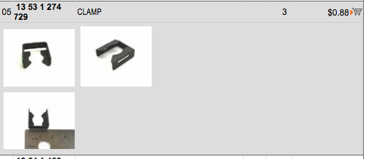

Where can I find those clips and could that be the issue?
If you have run this engine, the clips are wherever you disconnected them from the injectors.
* K75 injector clamp, from MAX BMW parts fiche.png (29.65 kB . 514x224 - viewed 730 times)
 Otherwise, you'll need to buy some.

Post by: Filmcamera on June 14, 2017, 08:54:56 PM
You can find them here for sure
Start by putting in your bikes model and year and the last six digits of the VIN
That way you will be fairly certain any parts are the right ones for your bike
http://www.maxbmwmotorcycles.com/fiche/fiche.aspx (http://www.maxbmwmotorcycles.com/fiche/fiche.aspx)
This is the part number btw - 13 53 1 274 729 - seems to be used on pretty much every K bike
