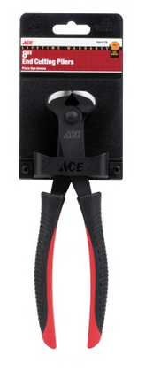

Post by: Laitch on May 20, 2017, 10:27:01 PM
My wire cutter pliars didn't have the oomph.
At the time, something like this was what I used. I still don't have a Dremel, yet.
* Nail cutter:puller.png (71.35 kB . 173x419 - viewed 268 times)
