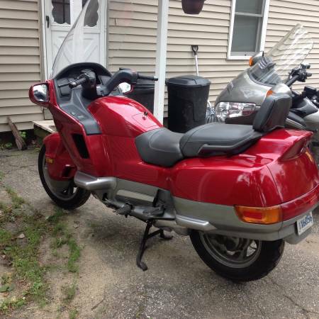

 Hey, I saw one of those oversized scooters, a P C go by my house the other day.  Blew my mind.  I have never, ever seen one, cept for the photo you put up here!  I was like.............what the hell is that.....................holy shit its that ugly freakin bike Laitch posted! :mbird Is that a Honda?

Anyway, the PC is my dream bike. :Rabia: It has the perfect initials for Vermont.

Really Liatch, the PC 800? I thought you had taste!? :mbird And seriously. I didn't even know they existed till your post. Then out of the blue one drives by!  What is the message there?
You must hunt down the owner and offer him your K1100 in trade.
