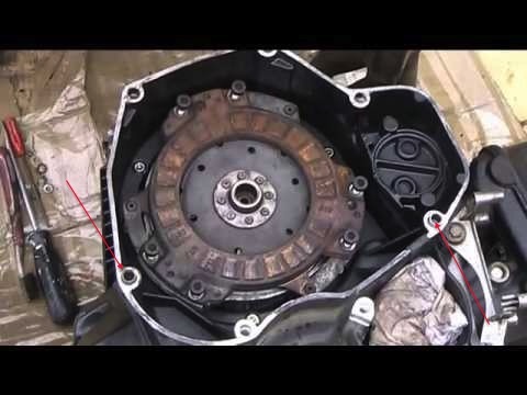

Post by: bobmusick on May 08, 2017, 04:38:54 PM
Hi all,
I was able to get the transmission off yesterday. I got it up on the workbench and opened it up, to my surprise it seemed like everything was fine. So I looked back to the clutch, which at first glance (to someone who has never really looked at one before) seemed fine. But then I saw that the teeth in the center of it were pretty ground up. So I guess it looks like all I need is a clutch? Or the center part of it? All the oil in it was clean. Actually all the oil everywhere was. So it was probably a bad idea to open up the transmission buuuut I tend to always skip to the more complicated stuff before looking at the easy and simple solution.
(https://uploads.tapatalk-cdn.com/20170508/2f8b57a64f4975a0598f2f74a0975fda.jpg)
(https://uploads.tapatalk-cdn.com/20170508/e3bb8dce7dec769989bcd6ad63549832.jpg)
Another quick question before I put the transmission back together... it looked like there was some sort of sealant on it, and I couldn't see about any in the manual I use.
Thanks!! Should be pretty easy at this point is seem.

Post by: Laitch on May 08, 2017, 04:52:26 PM
Post a straight-on photo of the splined shaft the mated to the clutch disc.

Post by: Martin on May 08, 2017, 06:12:06 PM
Splines look stripped. I think you will find that when you remove the clutch plate and stick it on the input gearbox shaft it will probably just spin.

Post by: Andy FitzGibbon on May 08, 2017, 07:12:04 PM
You need a new clutch, and- depending on the condition of the mating splines- possibly a new transmission input shaft as well.
How do the driveshaft splines look?
Andy

Title: Stuck on side of the road... (clutch?)
Post by: bobmusick on May 08, 2017, 08:28:41 PM
So here is the shaft and clutch. I think the clutch only needs replacing, the shaft seems fine (to me at least)
(https://uploads.tapatalk-cdn.com/20170509/96f0def990cb746b8e8133e87f7e4b6e.jpg)
(https://uploads.tapatalk-cdn.com/20170509/135a2a14139b41246eb47ceda1ffd311.jpg)

Title: Re: Stuck on side of the road... (clutch?)
Post by: Laitch on May 08, 2017, 10:17:04 PM
I think the clutch only needs it, the shaft seems fine (to me at least)
From what I can see, it looks too worn to work well. Try another head-shot with the entire splined surface exposed. I'm basing my current opinion on the low height of the splines at the front, and the drop and taper of the splines from the rear to the front of the shaft. The depth doesn't seem adequate to transfer torque successfully.
Post by: Elipten on May 08, 2017, 10:38:20 PM
Looks highly worn to me, but some better photos are in order.  But I would not put it into my bike.
Post by: jakgieger on May 08, 2017, 11:16:42 PM
Years of working with machines, gearboxes, and pto shafts has taught me that if you put "rounded" teeth engaging on  "new" teeth, failure will result.  The only question is the amount of time.  Since there are irregularities in the mating surfaces you also introduce the elements of vibration and possible shedding of metal fragments.  Neither situation is desirable if you intend long term operation.  I went through a similar scenario in a farm truck.  I first tried to rig it "on the cheap" with used mismatched recycled parts.  The third time I fixed it, it cost a new input shaft, several bearings, and a new output shaft.  It was in a pulling truck and under severe load, but the principles involved are identical. Good luck with whatever you decide.
Post by: Martin on May 08, 2017, 11:24:28 PM
+ 1 From what I am seeing it looks like a clutch plate and a shaft replacement. The shaft might last for a little while but  its on the way out. A worn shaft with also cause excess wear on a new clutch plate.

Post by: Elipten on May 08, 2017, 11:55:14 PM
Before you put money into the bike, show us the drive shaft and rear drive splines.
How many miles on the bike?
Your plans?
If you intend to ride for ever, replace clutch disk and transmission input shaft or the transmission.
If selling and screwing the buyer, then new clutch disk, grease it and sell it to an unsuspecting person and live with yourself.  I could never do it, but many do.

Post by: bobmusick on May 09, 2017, 12:06:32 AM
Here's a better view of input shaft. Seems like general consensus is to just go ahead and replace that too. And now that I'm looking at it, seems like most of it is pretty worn anyways. Bike has ~46k on it and I plan on keeping it for who knows how long, so it would just make sense to fix it up right the first time while I'm in here already.
(https://uploads.tapatalk-cdn.com/20170509/f1aede39d8301e26fae7ae8110b10a80.jpg)
(https://uploads.tapatalk-cdn.com/20170509/620ab51e13da7c3414bf32949831f482.jpg)

Post by: bobmusick on May 09, 2017, 12:09:03 AM
One more angle
 (https://uploads.tapatalk-cdn.com/20170509/7e4efab69cdf07c71396a862174bbb45.jpg)
Post by: Laitch on May 09, 2017, 12:12:09 AM
One more angle
I think you should find a replacement but first, let's have a look at the final drive and driveshaft splines.
Post by: bobmusick on May 09, 2017, 12:16:57 AM
Dang more work huh. Alright, climbing into bed now but I'll be sure to find time tomorrow for it.
Post by: Elipten on May 09, 2017, 12:19:05 AM
You can see it is highly worn.  Look at the raised section at the transmission end.

Are there a couple of locating dowels on the transmission or intermediate housing mating surfaces? An example is indicated in the attached photo.
* Locating dowels.jpg (43.79 kB . 480x360 - viewed 728 times)

Are there a couple of locating dowels on the transmission or intermediate housing mating surfaces? Examples are indicated in the attached photos.
So looks like I have only one of those little dowels unless it fell out. Will look around for it but it didn't seem like it was there.
(https://uploads.tapatalk-cdn.com/20170509/b4a7e563d1a3c8ecf141860275994156.jpg)
