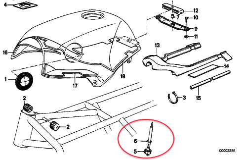

Post by: Batkinson on February 01, 2017, 12:43:06 PM
I am with you on the seal where that connector for fuel pump power and fuel level indicators comes through. Unfortunately I am having some difficulty in finding any parts diagrams which refer to the connector assy or associated O-rings/gaskets, or a remove/install procedure. Any assistance would be greatly appreciated.
Where have you looked, Batkinson?
Get the K75/K100 BMW repair manual from the Technical Library Index here. The manual is stored under the heading BMW Workshop Manuals. Look in it for the Fuel Tank Layout diagram. It's just a nut-bolts-and wires procedure but patience and penetrant can be useful. Check the MAXBMW parts fiche for component part numbers.

I checked the manual for a good amount of time by both manually scrolling and using cntrl-f to search. I have looked at page 16-06.0
I found lots of references to fuel pump and a procedure on page -16-15.0 referencing the removal and replacement of the actual fuel level sensor,  but the electrical connection, the big black circular plug as shown in my pic, I can't find referenced or am not making the right connection between the drawing and the reality.
I had checked the microfiche at Bob's BMW and the MAX BMW fiche ( sections 16_0238,  16_0808, 16_0809, and 16_0815) but can't visualize any of those parts as the connector. When I look down into the tank the fuel pump assy seems displaced too far from where the connection passes through, and it doesn't seem  the connector is a part of the fuel pump. Perhaps brainlock from too much gas fumes?
I'll take another look, but I hate just wrenching on the nut without a better idea of WTF I am possibly screwing up. Any help is greatly appreciated

It took me two seconds to find this (http://hrsbstaff.ednet.ns.ca/bvogel/K100/download/electrical/fuel%20sensors/fuel%20level%20sensors.htm) using Google with the words K100 early fuel sender connection. I would have found it sooner but I spent a few moments laughing at your response, Bat. It's also in the MAX parts fiche.
* Early sender unit with big black plug, from MAX BMW parts fiche.png (62.34 kB . 500x323 - viewed 862 times)

In defense of Batkinson, let me say that I looked at that parts fiche several times and didn't see parts 5 and 6 as the parts in question.  Like the O.P., not ever having that particular sending unit apart I didn't know what the parts would look like on the fiche.  That it was listed as a gauge and not a sending unit didn't help either.
