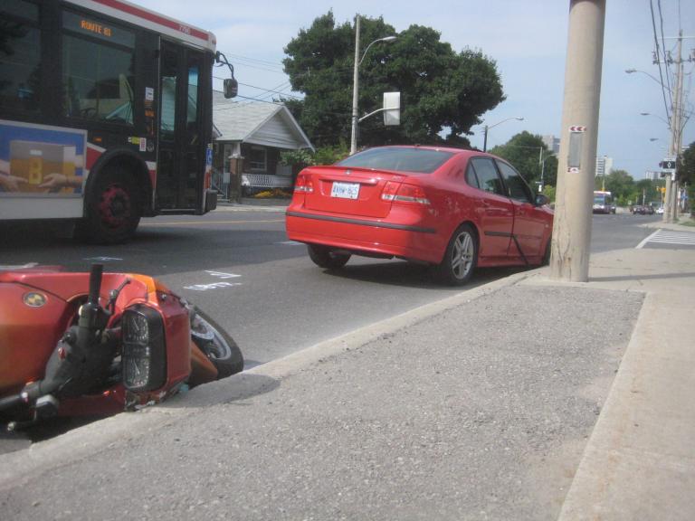

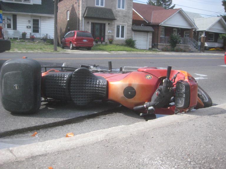

Post by: bocutter Ed on September 11, 2018, 03:03:21 PM
How did the bike fare in the assault?
Not too bad, I guess, considering I had 2 car lengths notice, @ ~50 kph, that he was pulling, from 0 kph, into my lane. Tagged the passenger door, then the curb ...
Windshield, both mirrors, center & right fairings, valve cover, crank cover.
Notice the white start button (staying on topic  :giggles ).
