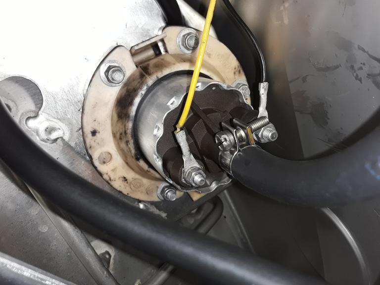

Yesterday I got back to working on my K75 project bike. I'd left the fuel pump out for quite a while and it was frozen - FARK!!!
Now I'd have a chance to see if the $30 solution would work. Sure enough, it did.
It only took a few minutes and was very easy to do:
1) Remove the old fuel pump. a) Undo the hose clamp and take the fuel hose off. b) Undo the electrical connections(7mm and 8mm) c) Pop the plastic clips at the front and rear of the mounting ring. (You don't need to undo the 8 nuts on the plastic mounting ring.)
2) Once out of the tank, slide the old fuel pump body out of the incredibly expensive rubber vibration mounting ring.
3) The diameter of the FEP2042 is much less than that of the BMW fuel pump. There's a section of submersible fuel hose that comes with the fuel pump. How convenient. I cut it's length to slightly less than the diameter of the new fuel pump, ran a nylon zip-tie through it and wrapped it around the new fuel pump and secured it with the zip-tie. With a few minutes of careful cramming I was able to get it nicely lodged in the vibration mounting ring.
4) Attach the pre-filter that comes with it to the bottom of the new pump. If you fold it up a bit it will fit nicely in the fuel pump "pocket" of the gas tank. Insert your new fuel pump assembly into the fuel pump hole in the tank and make sure the clips pop into place.
5) The nozzle on the top of the fuel pump has a slightly larger diameter than the BMW one but the hose will fit over it. The IBMWR instructions say that the BMW hose clamp is too small to work. Not true. If you drop the hose clamp on first and then slide the fuel hose on you can use the old hose clamp.
6) Wire it up. Cut the ring terminals off of the black and yellow fuel pump wires from the tank. Put female blade connectors on each wire and crimp carefully. I used bare metal ones - who knows if the plastic on covered ones would dissolve in gas. Attach the black wire (ground) to the narrower blade terminal on the fuel pump. Attach the yellow wire to the wider blade terminal.

Post by: mjydrafter on May 06, 2013, 08:12:39 PM
I tried to get a decent pic of my fuel pump, it's a difficult subject though.  This is about the best I can do:
(http://i216.photobucket.com/albums/cc295/mjydrafter/20130506_163921_zpse298a766.jpg)
Still working.

Post by: enb54 on July 03, 2021, 05:25:32 PM
Finally! Got this aftermarket pump and new fuel lines installed, the aftermarket collar was broken so had to clean and re-use the original, had some problems reinstalling when the locking parts would not latch, but finally solved, picture attached... [ Invalid Attachment ]
Title: Re: Aftermarket Fuel Pump
Post by: beemuker on July 03, 2021, 06:54:42 PM
congratulations.  icon_cheers I replaced my in tank lines yesterday with the Gates hose I got off Amazon. 1 foot was barely enough after I cut a short piece off for the filter connection.
Post by: enb54 on July 03, 2021, 07:05:20 PM
Thanks, had a devil of a time fitting everything properly and of course the collar arrived broken but didn't realize it, anyway the process is completed. The old fuel lines must have been original, they were swelling badly, plus the shock absorbing material was sort of like liquid rubber and floaties from it had caused the filter on the original pump to clog up, likely causing the pump to fail. Anyway, too hot to continue, will finish up tomorrow...
July 04 Edit:
* 20210704_134901[1].jpg (49.91 kB . 768x576 - viewed 661 times)
Modification to position of fuel line clamp...
