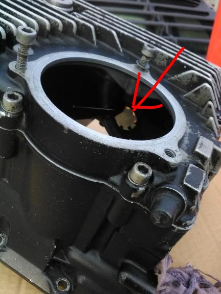

The sight glass might not need to be replaced, it might just need a clean, or the silver plate behind it might need cleaning also. If not for the silver plate behind the glass, you would only see into a black sump.
After removing the oil filter cover and the oil filter, you will have access to clean them from the inside.

To clarify, the sight glass is composed of a sealed ring surrounding a clear plastic lens in the front and a silver perforated disc (indicated by arrows) in the rear. Oil enters into the space between the lens and the disc corresponding to the acceptable oil level in the sump.
(https://motobrick.com/gallery/4/1601-270926131720.png)
Cleaning from within the sump would seem to require flooding the space between the lens and the disc with solvent through the holes in the disc until both surfaces are clear. Scrubbing would require careful use of a brush or sponge mounted securely on a thin flexible wire.
