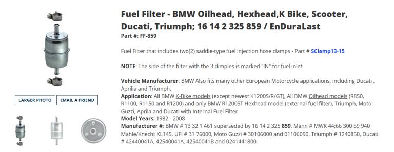

As for the fuel filter here's where things get interesting. I did install a new filter it was the first thing I thought of after I reseated the injectors for the first time, I also re installed the old one afterwards to see if somehow I had installed the new one backwards or something or bought the wrong one. Both blow through "fine" from both ends but putting the old one on somehow helped the throttle lag although Im going to be completely honest it might have been something else. Tank seems to be in fine condition no floating gunk, when the tank was emptied I did notice a bit of grime stuck on to a wall around the very bottom but nothing I was particularly worried about and I have tightened the dickens out of the interior fuel lines none of which seemed to be in bad shape. I will put the new filter back in I will attempt to take some pictures of all the lines, unfortunately I think the tank is slightly full right now which should be a fun challenge to not ruin the paint, lots of towels I guess.
Fuel Filter I bought - Went for the cheap one? Kind of figured a paper filters a paper filter but maybe that's my problem? I mean It's probably placebo that the old one was better in the end so Idk I'm easily persuaded old filter had a bmw badge, after it wasn't working right I thought maybe it was different so I put it back in I guess.
https://www.euromotoelectrics.com/product-p/ff-859.htm (https://www.euromotoelectrics.com/product-p/ff-859.htm)
* Filter from moto lectrics.png (36.99 kB . 768x297 - viewed 209 times)

The replacement fuel filter is a common one for this application and reports indicate it seems to work well despite its low price. :laughing4-giggles:
