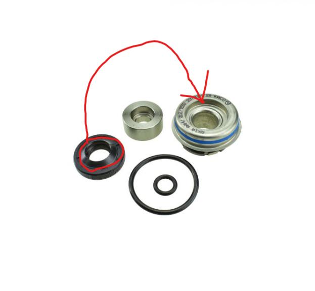

For future reassembly reference it appears then that this section of the oil seal should rest inside the water seal as so expertly depicted below?
If that is the case then yes I think the oil seal was installed backwards, but clearly it worked to some extent because it's been there for some time.
* Screenshot 2025-09-07 230852.png (18.4 kB . 623x576 - viewed 1141 times)
The conical side of the seal should face the water seal
its probably also hard to determine if it was installed incorrectly when molten and purging it from the pump.
And its what we call "mustard after the meal" (freely translated). It doesnt really matter anymore what was, as long as re-installing is done correctly.
