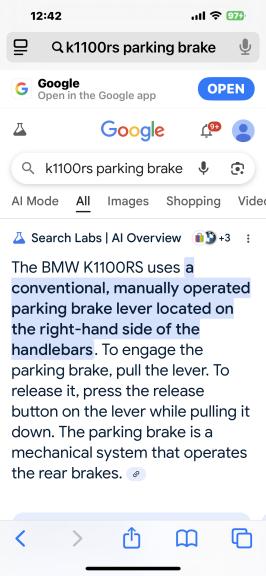

I was parking my bike after a short group ride and had a weird lockup. Somehow it mysteriously released  luckily. Afterwards the thought occurred to me that maybe I activated a hill or parking brake type of action. Don’t see mention of it in the owners manual so, a quick google search says it’s a separate lever? I don’t have anything like that. How could I have caused it?

AI overview is frequently inaccurate and not to be completely trusted without verification from other sources.
Until then, what could have happened—among other mysterious and perhaps karmic-related events—was the tiny return port in either the front or rear master cylinder could have been clogged temporarily by water or schmutz thus interferring with the action of one of the brake pistons. It could be a sign to do a thorough flushing of the front and rear brake systems.
Or perhaps AI just chose to screw with you, to wit:
(https://motobrick.com/gallery/4/1601-200725115437.png)

I can’t believe Mr Google lied to me after we’ve been friends for so long.  177381
