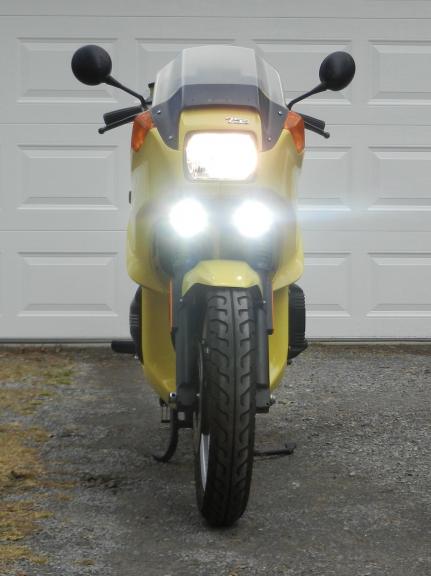

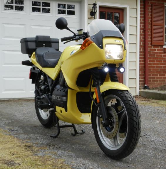

What is annoying you is the turbulent spill off the top of the windshield.  I'm 6'1" and had put a taller Aeroflow shield on my K75S and found that it only raised the impact point of the turbulence a couple inches higher on my helmet, about right on the visor.
After a bunch of experimentation what I found to be the best solution was to get an old stock windshield and cut it down about 4 inches.  That put the turbulence down on my chest greatly reducing the noise and buffeting on my helmet because it was now in a clean airstream.   I also had a K75RT with the same problem, and I did the same thing cutting it's shield down which not only reduced the buffeting but also made the bike a little bit cooler to ride in hot weather.

As far as cutting the windshield, I covered it with blue masking tape, front and back and marked where I wanted to cut it.  I cut it with a jig saw using a plastic cutting blade.  Hold the windshield securely and go slow.
After the cut, I cleaned up the edge with a file followed by wet sanding with finer grades of sandpaper on wood blocks starting with 100 grit going down to180, 220, 320, and 400.  Keep going with finer grades until you get the finish you like.  Avoid sanding on the front or back surfaces.  Just work at rounding the cut edge to avoid scratching the windshield.  Taping where you don't want scratches to protect the surface is a good idea.  Take your time.
