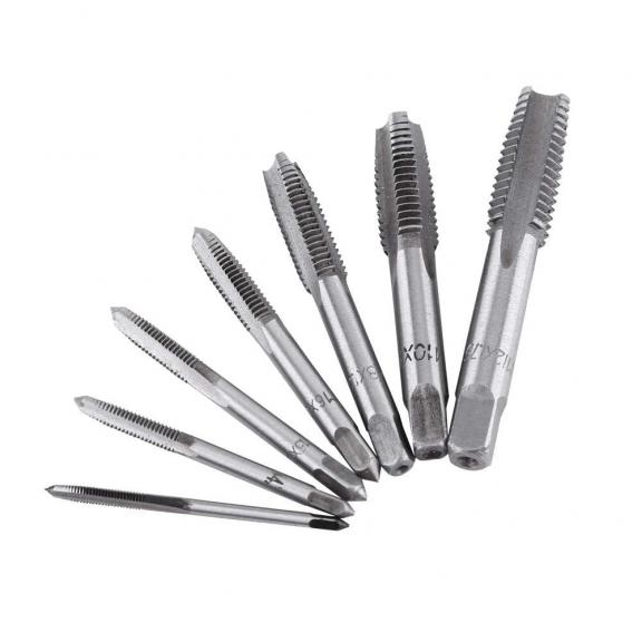

Well, yes they are but not the reason i've asked for help initially. However some of these tips provided additional insight and will be applied in the future. And for now this is - besides 1 exhaust stud bolt - the last one
Its one of these units thats broken off below the hole's surface.
* 61ufdWvvwUL.jpg (26.28 kB . 576x576 - viewed 667 times)

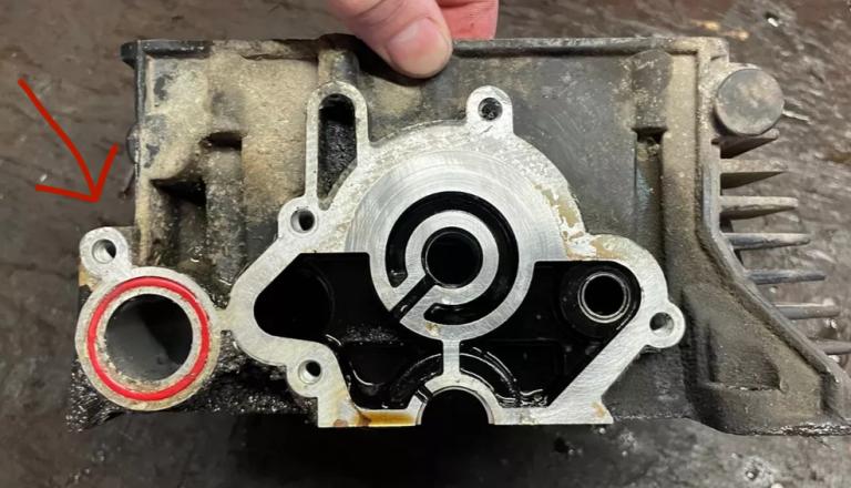

In this place, which requires a bit more caution
* IMG_20241119_172823.png (58.3 kB . 768x440 - viewed 695 times)
Furthermore seeing the colour [blue and browish sludge/layer/powder] made me start to believe the bolts were refastened with Loctite which i havent seen before on a untouched engine.
The image is not mine, not my hand nor my pan. Just for indication purposes

Post by: Laitch on November 19, 2024, 12:30:17 PM
I was about to compliment you on your hand and finger grooming and suggest you supplement your income by hand-modeling, but I guess I won't.
Instructions applied to broken bolts apply to broken shanks of any type including those of broken extractors, but the type of bit used on tough steel needs to be the most effective one as I indicated. Blue Loctite doesn't need heat for release but red Loctite does.
