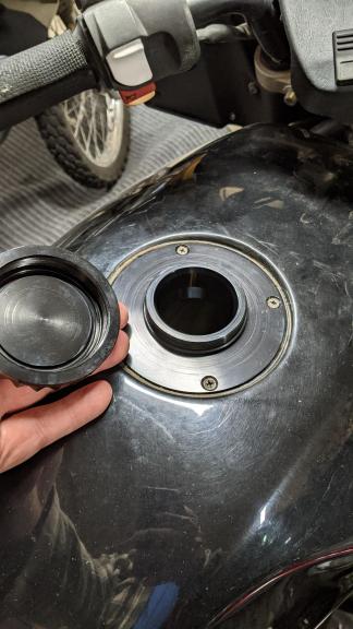

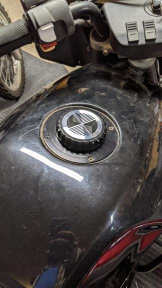

I found a non-key tank fill cap to replace the OEM keyed flap cap.  I'm always concerned with needing a key to open a gas cap.
However, while cleaning up the removed OEM cap, I noticed it appears this is the tank vent.  The non-key replacement does not have a vent.  This has been done in maintenance season so I haven't had an opportunity to run it to see if it caused a problem.
Is this the only vent on the tank?

Post by: Laitch on November 17, 2024, 01:29:42 PM
Post some photos of the two caps, please.
All Brick tanks also have a vapor vent outlet located toward the rear of the tank's floor; excess fuel can also exit the tank via that vent. Next to it is a water outlet that diverts water that might accumulate around the tank's fuel cap.

Post by: 2000rsv on November 17, 2024, 05:49:25 PM
OEM gas cap
Title: Re: '86 K75C - Gas Tank Vent
Post by: 2000rsv on November 17, 2024, 05:50:26 PM
Non-key gas cap.  I'm sure it was made with the best prison labor in China.

Post by: 2000rsv on November 17, 2024, 05:54:01 PM
I did take the OEM cap apart and clean it up.  There was enough gunk inside that the two pins at the bottom of the lock did not sit properly in the mating holes.
Little dry graphite in the lock.  It works much more smoothly now.  I still like a non-key cap if it doesn't cause any issues.  I have them (different style) on my GSA and K1600 and really like it.

Post by: Laitch on November 17, 2024, 08:49:15 PM
If it doesn't cause vapor lock or spillage of gasoline from a full tank during a hot day when parked, it should be good to go.
