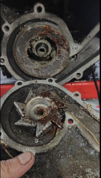

Post by: Kaos on October 29, 2024, 01:36:07 PM
I am not the biggest brick fan fan.
On top of all the mentioned fixes problem solevers etc.
And finding gunk in your coolant you might also to do the following:
Remove the coolant pump cap from the front and also check the situation there.
Gunk tends to heap up there, it also allows for better drainage.
White wine vinegar is an absolute good option to use for rinsing, but mix it with demineralized water 250ml to 750ml
Check the fan for obstruction/resistance.
While the system is drained you can check the electrics by removing the temp sensor and heating it with a heat gun (watch your fingers) or by sticking it in boiling water.
De keep in mind that rinsing works best on a heated cycle so you must ride with it.
For illustration purposes:
* Screenshot_2024-10-29-18-44-02-88_99c04817c0de5652397fc8b56c3b3817.jpg (35.79 kB . 327x576 - viewed 890 times)
