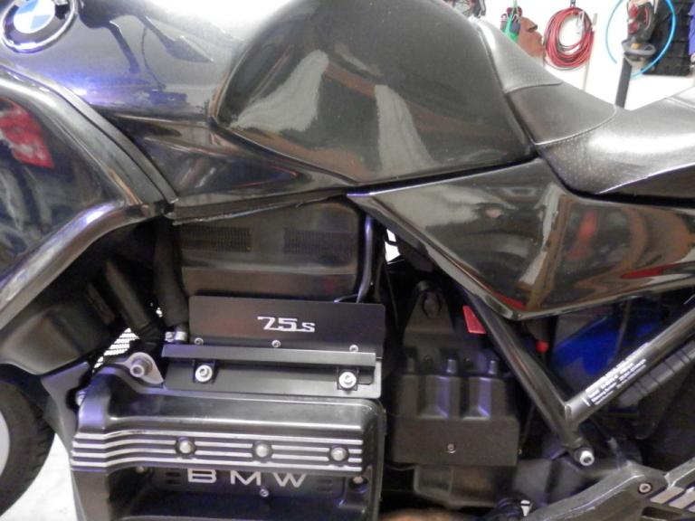

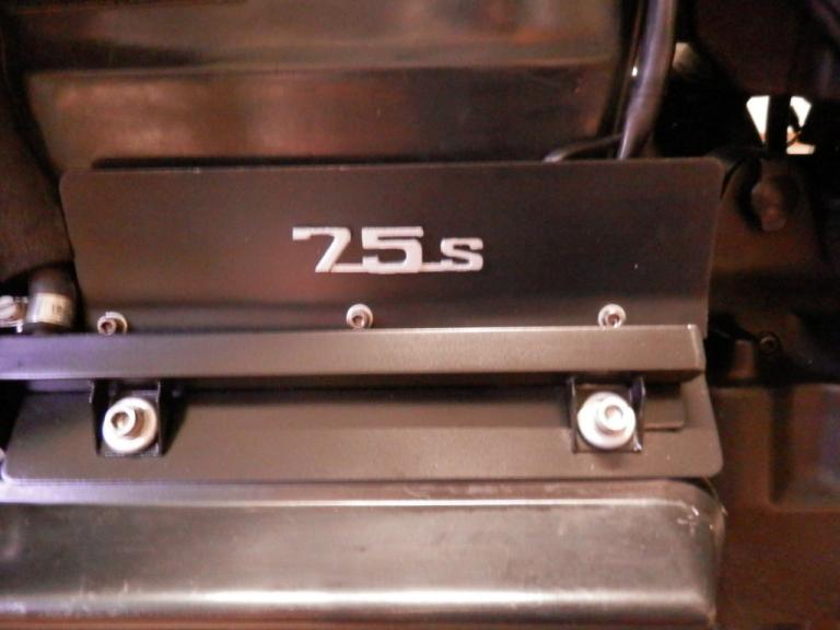

Post by: Martin on September 20, 2024, 06:14:16 PM
 After playing with a home made cooler that only worked at 80 Kph I went old school hot Holden solution.   https://www.k100-forum.com/t14096p50-overheating-fuel-solution-mk1-new-improved-mk2#189438. I've been running a heat shield since 2018 and it's staying as the bike is a lot cooler. IMHO it was better to stop the fuel overheating in the first place than to try and cool it down once it had heated up.
