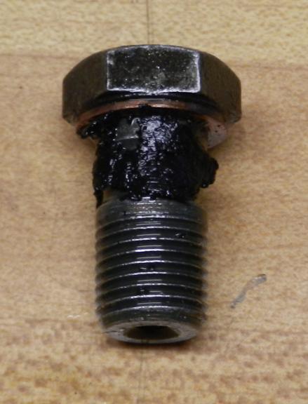

Post by: The Mighty Gryphon on June 15, 2024, 07:26:20 PM
* DSCN3047.JPG (51.83 kB . 670x576 - viewed 818 times)I can't remember the bike I took this fitting off of.
* DSCN3050.JPG (26.65 kB . 540x576 - viewed 810 times)
* DSCN3052.JPG (32.52 kB . 439x576 - viewed 910 times)

Post by: frankenduck on June 15, 2024, 07:40:43 PM
If you plan to replace the brake lines then I recommend (and use myself) stainless lines from Motobins in the UK. Price and shipping are reasonable and only takes a week or so to get to the US.
You can usually tell if a brake line is bad by trying to blow air through it. What happens with old K brake lines is that the interior of the the brake line breaks down and clogs it. See TMG's pics above.
