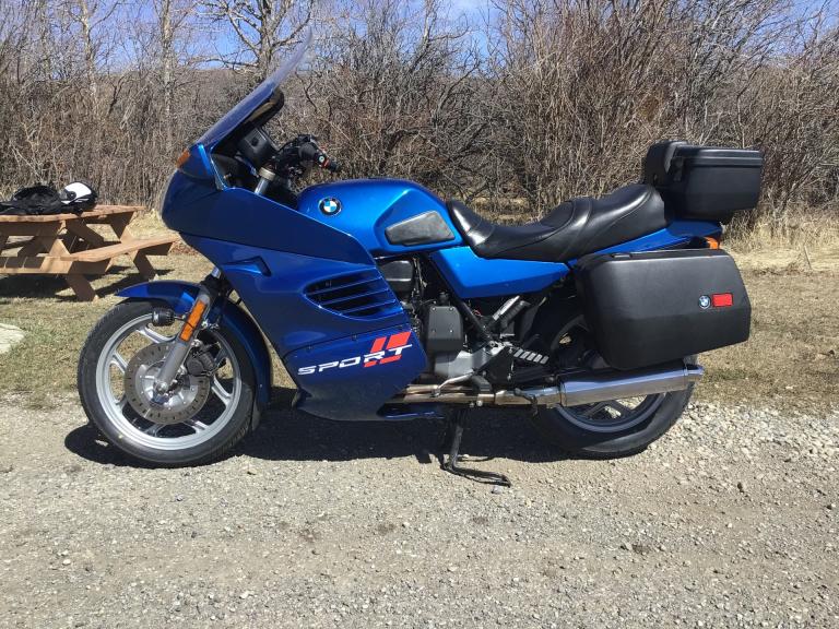

Another K-anadian. It's got bugger-all for miles. Some elbow grease and a good going through should give you a really nice bike. Owners say they have engines as smooth as electric motors. As for parts, there is also Motobins and Motorworks in the U.K. I'm down in Calgary, by the way.
