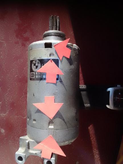

I'm wondering about the possibility that the starter motor might not have been reassembled correctly, it's happened before. In this case the starter might be turning backwards.
Title: Re: Unstick Starter Sprag with heat?
Post by: daveson on March 30, 2024, 06:37:57 PM
The markers need to be aligned as in the photo.
Post by: The Mighty Gryphon on March 30, 2024, 10:20:53 PM
* IMG_20240331_092607.jpg (27.4 kB . 432x576 - viewed 519 times)
+1
You wouldn't be the first person to put the starter together wrong.  I have beaten you to that honor.

If the sprag only turns one way (by hand I'm assuming) that makes me think, yes the starter might be spinning backwards. Do the markers on your starter match those in the photo?

Hmm, the metal indentations on the starter body/cylinder (attached photo) do Not look exactly like the correct-example photo above.
At this point, I would be happy to have the non-starting be due to my literally backwards mechanic'ing, so I can get my Brick on the road again.
Bring on the photos!

Post by: daveson on April 01, 2024, 03:48:24 PM
Spin the body around, line up the marks, problem solved.
Edit: Added arrows to the photo. There's one indentation at the top and two on the bottom, it should be the other way around

Post by: schrocketeer on April 15, 2024, 03:38:27 PM
Things work better when the Starter turns the right direction. After turning the magnet holding cylinder around, the Starters works as expected.
Thanks for help everyone. :-)
