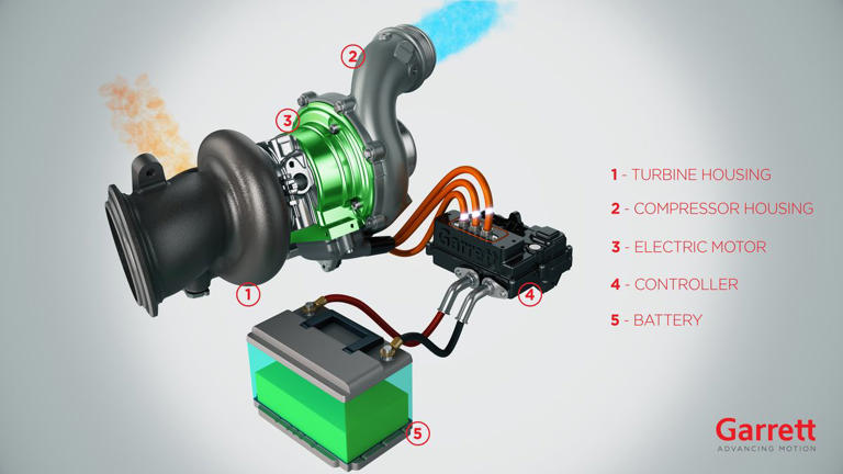

Post by: Arktasian on February 07, 2024, 09:03:37 PM
If however, we were wishing to get real fancy, consider this little gem
* Garret E Turbo.jpg (64 kB . 768x432 - viewed 1096 times)
Traditional, exhaust driven turbo with high efficiency electric drive motor to get to that sweet spot just a bit sooner  112350
