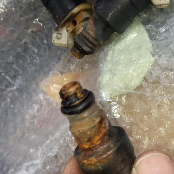

Hello, I come back with good news and hope useful information for peoples got same problem.
Yesterday I change my injector by new from bosch (recent 4 holes injector, bougth here : www.caferacerwebshop.com, ref on them are 0280158034).
first look to my old injectors :
* 20230826_122100 (Grand).jpg (39.47 kB . 576x576 - viewed 539 times)
I mounted new (after some adventure with ramp and stuck old injector), I made also an idle adjustment, I wend riding..and all my problem goes away!
No more instability at low rpm, velvet and watt !
Conclusion : For those who went remove big air box and put flow meter in vertical position with cornet or other filter, this work perfectly !

Thanks for the update, Man! I hope you've recovered from the shame of beautifying your ride but leaving those dilapidated injectors in its gut.  :laughing1: What is the brand and specification of the brake cylinders and levers you are using?

thats good information m8 as i'm planning to do the same mod to my k100 and i had reservations about mounting the Maf sensor vertically. my injectors also look like yours and the T/B are minging so they are away for ultrasonic cleaning and i will try the injector refurb kit from bmw parts holland first as its only £25 , if that does'nt work i will replace with EV14 injectors
