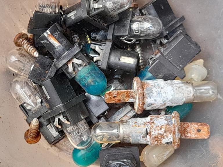

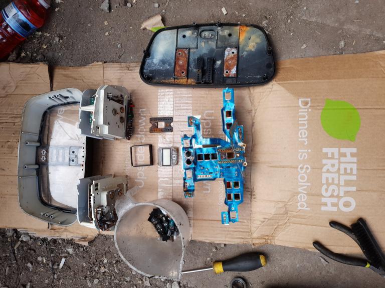

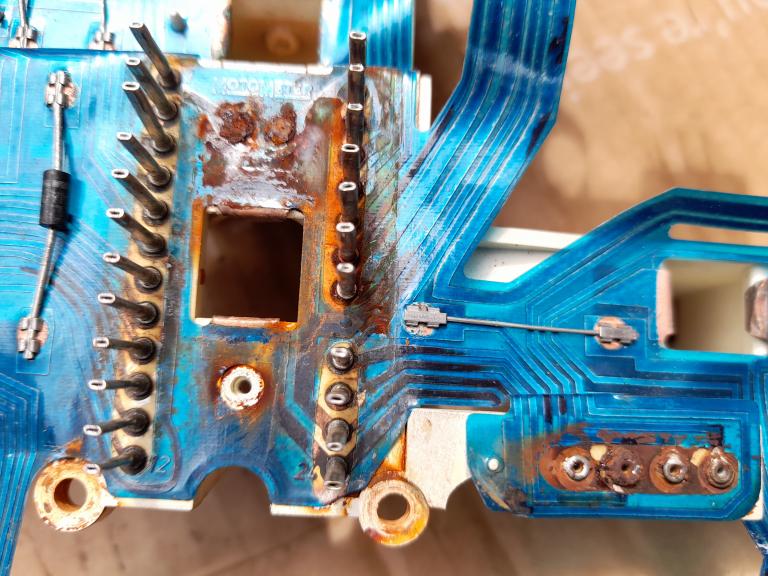

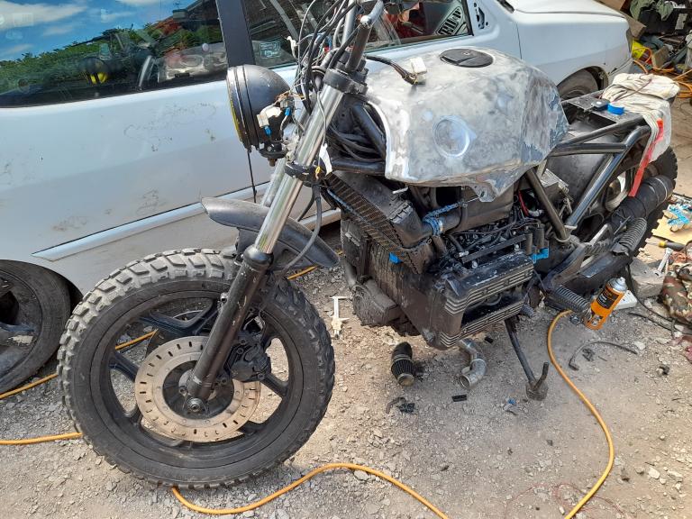

Post by: bitsa on June 01, 2023, 10:03:13 AM
Got photos
The poor beast as it currently sits.
* 20230601_142519.jpg (107 kB . 768x576 - viewed 1956 times)
* 20230601_142443.jpg (83.78 kB . 768x576 - viewed 1913 times)
The instrument cluster debacle...
* 20230601_142423.jpg (76.07 kB . 768x576 - viewed 2011 times)
* 20230601_142415.jpg (60.36 kB . 768x576 - viewed 1897 times)
* 20230601_142354.jpg (85.71 kB . 768x576 - viewed 1937 times)
* 20230601_142330.jpg (84.66 kB . 768x576 - viewed 1846 times)
To be fair, I'm more surprised that as much of the cluster worked given how grungy the guts are.  Testament to the quality of the original product, also the serviceability is top notch & as long as I can clean up the contacts without damaging the film I'm confident I can restore functionality. Only bit I'm less than enamoured with is the way the pins are riveted through both the film & the plastic. Going to experiment with cleaning and soldering if any have flaky contact.

Post by: Laitch on June 01, 2023, 10:15:03 AM
Laitch, you quite evidently (and understandably, since we're some 3500+ miles and one ocean separated) don't know me at all haha.
Thanks for the photos. That's a bit more scrambled than scrambler but resurrection is entirely possible, likely even without divine intervention.  :laughing1:

Post by: The Mighty Gryphon on June 01, 2023, 12:56:42 PM
I must admit that the patina on your brick is impressive.  That is a good point as currently, heavy patina is very hip.

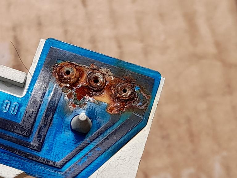

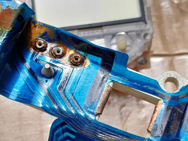

Having got further into diagnosing the clock I've come to the conclusion that along with being submerged aside the Titanic, these particular instruments also spent some years in the high desert. Aging less like a good wine and more like, well like a set of Brick instruments in the high desert, I believe the LCD displays have become completely baked & there's no longer any liquid crystal left to display anything...
Is this a common issue though? I've not really seen much about instrument cluster repair/refurb yet but will be plugging that into the search box in a moment or two. Hoping there's a reasonable solution to fix the displays since (being the strange animal that I am) having functional clock & gear indicator would be quite desirable to me. After all, I have the makings of them so why not try and have 'em do what they did back when this cluster was out racking up it's first 108k miles?

Post by: bitsa on May 19, 2024, 11:48:25 AM
Not so much an update today, more like closure for anyone following. The bike is now gone, sold to a guy who wanted it for parts so it's being chopped up and pieced out. Best thing for it if I'm honest, it was super ugly and beat up but lots of usable parts to keep other bricks alive.
Money's going toward a car build we've got going on, not going to be stock but definitely much less ugly and bastardised than the K.
