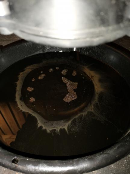

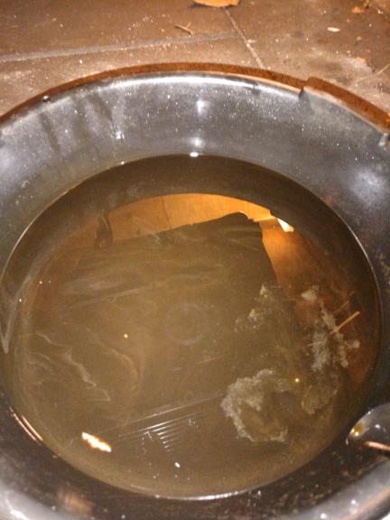

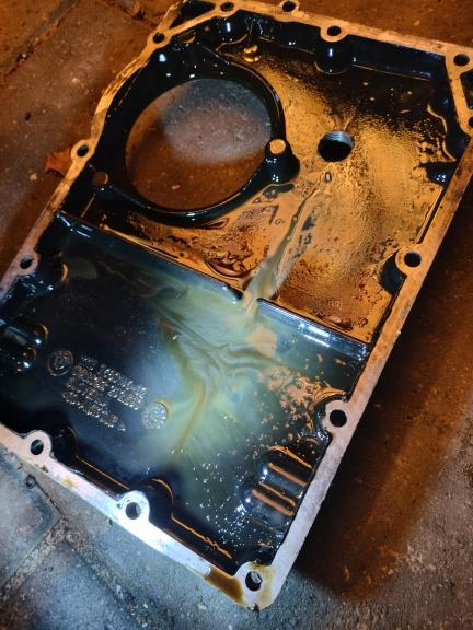

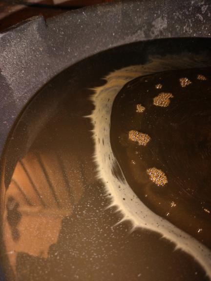

Streaks of yellow appearing in my sight glass on my last few rides in October before winter storage (Denmark it is 3 months, december-april), i decided to now drain the oil, and have a look at where the water could be coming from. As you can see in the attached picture, the water amount isn't crazy (there is picture of first drain and second drain where it drained for 2 days), but it has me worrying if i have an internal coolant leak/crack.

Could this just be condensation from the last few trips? (They weren't long) or being stored for 3 months? Or am I looking at a serious problem?

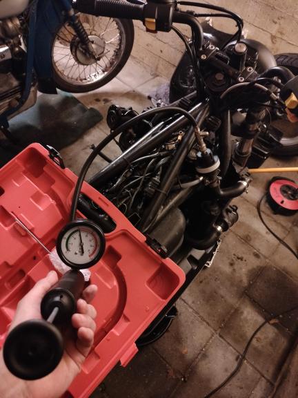

Coolant system pressure test @16 psi for 6 seconds and 15psi for 1h +, no apparent loss of pressure, and no leaking coolant when I view the block from below with oil pan removed.
