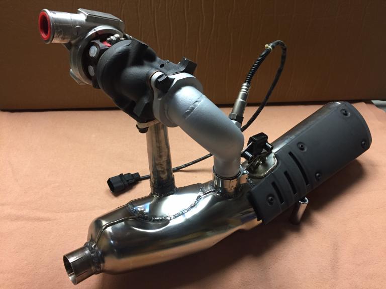

85 turbo project
 have the exhaust, turbo, plenum, injectors, fuel pressure reg, vac manifold
need to hook up hot and cold sides, oil feed, return pump, water inter cooler
& quite a few other details  ;-)

Wow!! 😵‍💫 not a project for the faint of Heart!!  Nice work so far! Looks like you are building a K-Rocket!

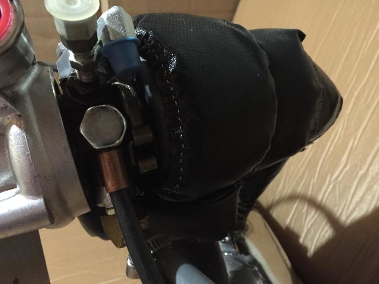

Post by: Arktasian on December 30, 2022, 12:00:53 AM
Excellent, almost didn't notice this (up in the special section)
Do you have plans to manage fuel/ ignition? Charge air cooler? Edit: just noted you have that on your menu.
I'm rather tardy with my project - it awaits final wiring but life has thrown some family weddings into the mix and that also drives more home reno work.
I've chosen a similar location but have opted to run original exhaust manifold as showing on below attachment. Also, that will provide heat to a bike that has a reputation already for being hot, so I've opted for marine grade heat blankets and a ventilating air system that comes off my A to A. (SS wire used to sew those guys).
Cheers and good luck.
