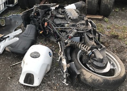

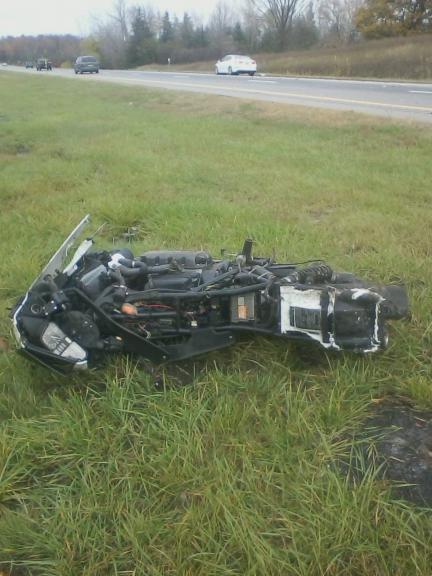

I was the victim of a vehicular assault that totaled my K100RS that had 128,000 miles as well as the KIA sedan that attacked me.
Your relatively intact survival from the encounter was astonishing.  A photo of that wreckage should be posted here under the title, The Case Against Slowing Down.  :laughing4-giggles:

Post by: The Mighty Gryphon on January 26, 2022, 02:51:28 PM
* at the yard (2).jpg (83.17 kB . 446x321 - viewed 506 times)
This is what old Moby Brick looked like after the larger bits were collected.  The debris field was about 75 feet long and 40 feet wide.
* In the median.jpg (43.83 kB . 432x576 - viewed 621 times)
White car in the distance is the attacker.  You can't see the 1 foot deep indent in the front.

Post by: foliver on January 26, 2022, 02:56:15 PM
Oh Mighty, your story is a very good one, but the picture, my god.
You were injured as the bike?
I hope not!
But an applause to your water lines!!!!!👏👏👏👏👏
