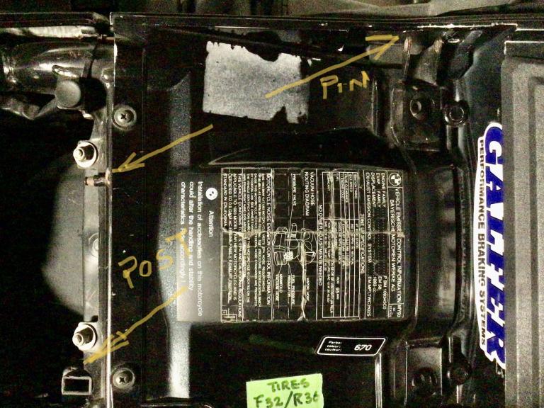

I’ll admit I’ve been riding with this seat simply set on the bike, and haven’t really cared. I would like to make it more secure if possible. The PO gave me the old seat hinge and pieces, but my efforts convince me I need something else. Is there a specific hinge you get when you buy the seat originally?

Looks like I need to source the early hardware. Might have some luck with the Local Independent Shop, Sport Cycle  pacific. Dave has quite a few K bikes in his parts lot.  I have this, and am missing the hold open link:
* FE8D2016-34BC-429C-BF70-EFC0992C4BC9.jpeg (61.36 kB . 768x576 - viewed 935 times)
* A9701CDB-6694-4702-8591-93BBC352BFBD.jpeg (59.92 kB . 768x576 - viewed 963 times)
* 048D2A03-A45A-49DE-A6BB-4553F629DDF0.jpeg (102.27 kB . 768x576 - viewed 951 times)
* ECD8C02E-BD63-4D93-A6E8-06BADB98A88C.jpeg (27.31 kB . 628x576 - viewed 977 times)
