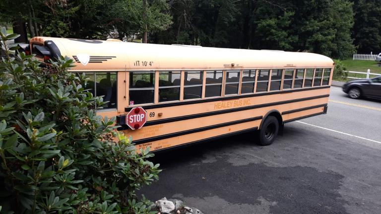

...and before anyone asks me why I am being such a wuss and not riding in the fall and winter when the grips are heated, I have a heated riding jacket and I used to ride all through the winter in Germany... it's because I have another project in the works, Lola la Puttanesca, the conversion of a 2008 International CE-300 39 ft school bus into a skoolie motorhome. No time to focus on anything but that, and a new job starting Monday next.
And yes, Lola is my kinda girl, big butt and a yuuuuge #69 plastered over the roof.  44271

I hope you plan to give that bus a Ken Kesey paint job.

Oh crikey! I had no idea Ray Charles had a decorating license! There are colors there that for the first time in history have seen daylight! And is that a UFC cage on the roof? Kinky!
