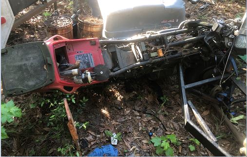

Just saw this, and reminds me of the condition of my first 1988 K75. I let it succumb to the same neglect, sadly. Got that bad even though a lot of its storage was under a roof! Dirt floor pole barn, so a lot of rust. I at least got all the gas out of the tank first, after the pump died. Unfortunately, with the tank off the bike, it grew legs and walked off all by its lonesome. After that, I was disgusted, and it sat out in the woods for two and a half years. Had not faded much till then, but looks like yours now. Only the tail and front fenders left, anyway! After riding the 1987 K75S I just bought, it reminded me how tough a brick is, and I'm gonna put 'er back together. Prolly take a couple years as my time and funds (and motivation) ain't what they used to be!
Seeing your brought back to life, gives me great inspiration. Fantastic job.
* small woods.JPG (58.87 kB . 507x322 - viewed 1162 times)
Got a way to go...
