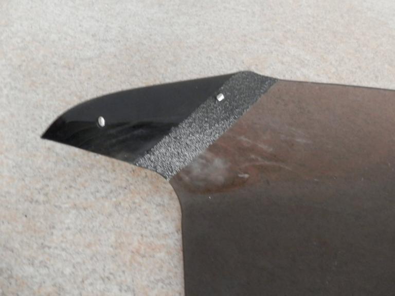

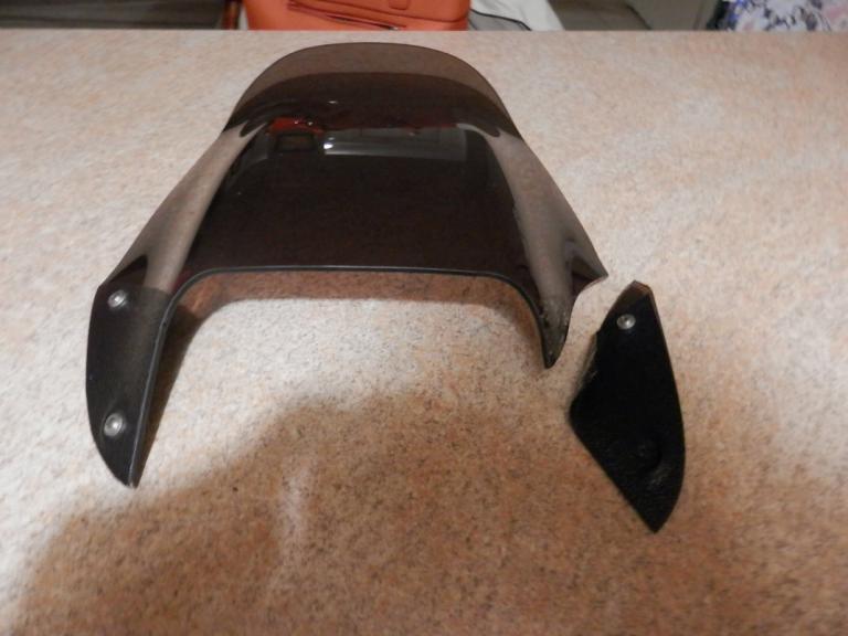

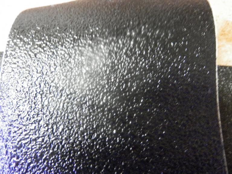

Post by: Martin on May 14, 2021, 05:07:49 PM
A bird strike took off my screen and the corner broke off on hitting the road. The break was repaired using slow set super glue and kicker. Unsure of the joint strength it was then reinforced with boat deck tape, which covers the repair.
* Windscreen Crack 2.jpg (46.73 kB . 768x576 - viewed 640 times)
* Windscreen Repair 1.jpg (54.72 kB . 768x576 - viewed 777 times)
* Windscreen Repair 2.jpg (37.8 kB . 768x576 - viewed 747 times)
* Deck tape 1.png (45.59 kB . 768x576 - viewed 731 times)
* Deck tape 2.png (90.05 kB . 768x576 - viewed 752 times)
