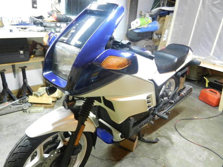

She is looking a bit rough... Sadly she sat outside for a long time and for a few years without even a cover.  She's filthy and does have some body damage that I will need to fix.
(http://www.motobrick.com/gallery/3/7328-180421191728-3687411.jpeg)  (http://www.motobrick.com/gallery/3/7328-180421191729-36991102.jpeg)
Man that is a dirty bike

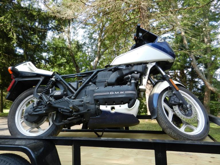

(http://www.motobrick.com/gallery/3/7328-180421191729-3699450.jpeg)
and after airing up the tires, and a bit of wrestling, she's on the trailer.  (Appreciate my bud helping here, and letting me use his trailer :) )
(http://www.motobrick.com/gallery/3/7328-180421191730-37011137.jpeg)
