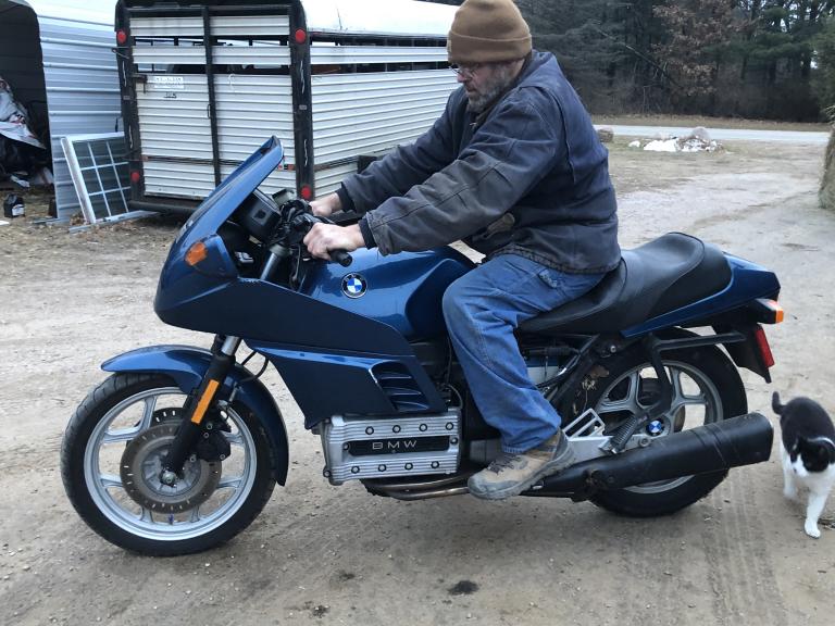

My legs are bent to the pegs and i am at the ankle moving the feet upward to shift/brake. Not just painful but dangerous because of lack of control.true im not sure i am going to take pics on it so you all can see . This sucks.

Went and looked at a photo of your bike.  It looks like somebody took a lot of the padding out of the seat so a short rider could reach the ground.  I'm guessing it's been lowered at least 1".  That could be a big part of your problem.
Try getting a chunk of hard foam about 1 1/2" thick and put it on the seat and then see how everything feels.  Another option might be to look at a replacement seat.
Another option might be to get a set of lowering blocks for the footpegs.  They will lower the pegs about another inch to let you straighten your legs out a bit more.

It looks like somebody took a lot of the padding out of the seat so a short rider could reach the ground.  . . . That could be a big part of your problem.
  112350
Additionally, although it might only be the perspective of the photo, the handlebar appears to have been rotated downward. If so, you could always loosen the clamps under the dash pad and rotate it upward somewhat. Check to be certain the fork braces haven't been lowered on the fork tubes. The tops of the tubes should be approximately flush with the top brace.

I agree it looks like it has some sort of 'low' seat - at least from this picture.

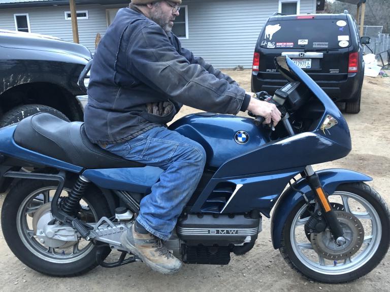

* 650E829F-3E41-4EB3-BC59-03A1C9987B74.jpeg (85.9 kB . 768x576 - viewed 844 times)
* F67BA9BE-9DC6-407F-A0A3-90A30ECF44DB.jpeg (84.29 kB . 768x576 - viewed 868 times) [ Invalid Attachment ]  [ Invalid Attachment ]

That seat had been hacked down.  You need a new seat.
However, you will need to get used to a sport riding position which is different than the bikes you have been riding.  I have a bunch of time riding K75S and k1100rs bikes with completely stock riding ergos (including bars in factory turned down configuration) and they are both all day comfortable.   I am 6ft tall and in the over 60 age group.

There isn't any adjustment you can make to that seat to make it more comfortable. It's seems to be lowered, as Gryph and K1300 have indicated, and it also seems to be pushing you forward and making your lower legs bend more than necessary. It looks uncomfortable as hell and seems to me that it would need more work than just additional padding to significantly increase your comfort.
You should start looking for a different seat. The stock bench seat would work for you but many seem to indicate that they're too firm for all-day comfort. I have one that had custom padding replacing the stock padding; it's comfortable for me all day. What I like about this bench seat is that I can easily shift my weight over it to change up riding position. It works well two-up. Attached is a photo of a stock bench seat on Special Edition RS.

Maybe someone has a regular seat and they have short legs and want to swap?  Your riding position does not look comfortable with me: your knees are almost above your hips, they're flexed over 90 degrees, and are pushed into the fairing!!
Taller/fuller seat would improve it I think.

Maybe look into an aftermarket seat like a Sargent or Corbin.  I have a Corbin on my K100RS, the original seat was shot when I bought the bike and rebuilt it.  It works well for me, others prefer more padding like the Sargent.  The K100RS definitely requires a 'lean forward' riding position.  I am 60+ and am good with that, but I also regularly ride a 'road' bicycle  which also puts me forward over the handlebars too.

In the picture in post #1, the handlebars appear rotated too far back.
In the pictures of you on the bike, the handlebars appear to be WAY too far forward.
The master should be level, like the RS Special.

I loosened the clamps and rotated the bars upward

I'm confused as you said you adjusted the bars.
bars and "master (cyl)" are two different adjustments.
bars are the bars.
master is part of the brake lever.  brake lever(and clutch) can, and should,  be rotated independent of the bars..
Title: Re: Riding position of k100rs vs zrx 1100-zr7 s etc opinions plz?
Post by: Blue85 on December 23, 2020, 08:57:18 AM
Yes you are right. I only rotated the handlebars up not controls i only wanted to see how it might improve the situation i didn’t ride it from there on
