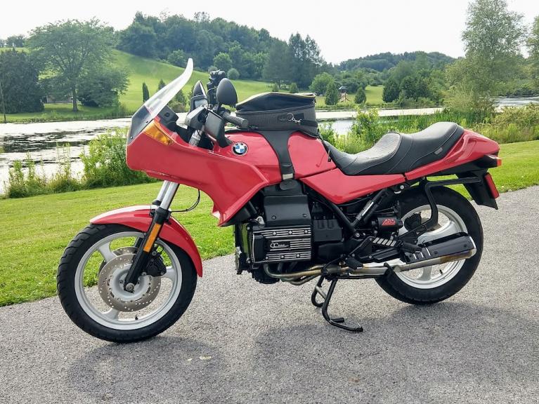

I am new here - don't even have enough posts to edit - but I'm starting a project thread to provide motivation to get this thing done.
A rehash of my 'new member' post:  I've owned this 1991 K75S since 1995 when I picked it up at the local dealer with 2500 miles on the clock.  I put the bags and tank bag on it.  Also added the Fox TC in about 1996.  The bike has 75000 miles on it now.
My plan is to go through it pretty completely.  New SS brake lines, rotors and pads, splines lubed, probably a new drive shaft - DS splines are worn but the final drive splines looked OK last time I was in there.  I've already done some stuff like new spark plugs and air filter.  I plan on replacing coolant and fuel lines.  Rear master cylinder is leaking.  Small drip from tranny.  And a bunch of things need to be improved:  rattles, non-solid fairing mounting, saddlebag mounts are worn, leans over too far on side stand, add conspicuity lights like Skene, etc.
I'm not a mechanic by any means but I've done a bunch of stuff on bikes - like clutch spline lubes, valve check/adjustment, fork seals, suspension setup and regular maintenance stuff.  We don't have a dealer close to central New York so I've had to learn to be self sufficient since we own 5 BMWs.
Pictures below are the bike ready for a cross country trip starting in San Diego in 2017, at about 70000 miles.  Then a couple of the bike as it sits this morning.  I staged the wheels and some of the stuff I'm painting.  The black parts are getting shot with appliance enamel.  I like how the forks came out.  The exhaust shield is glossy but better than rust.  I'm not happy with the wheels - but they are just going to get covered with brake dust anyway.
Oh, I want to do something with the seat.  I have always loved that BMW by Corbin saddle.  I've been using RTV to keep it together for about 10 years now.  I know others hate that seat but it works for me.

Thanks for the photos.  112350
Are you indicating that the side stand bushing is worn to an extent that the moto is leaning farther than it should, or that the angle of lean is disconcerting?

I think both.  This bike has always had a lot of lean while on the side stand.  The bushing is definitely worn - or the ears have widened.  I've never done any maintenance to the side stand.  Also, my side stand/clutch lever safety mechanism has been disconnected for a lot of years.  Probably 10 or so.  The nut that connects the side stand rod to the clutch lever disappeared and I never replaced it.

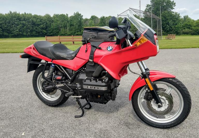

Post by: kurtk75s on September 30, 2020, 10:45:29 AM
A couple more 'before' pictures.   This illustrates the side stand lean that I will address.  I think the first picture is a bit of an optical illusion.  Or maybe I'm just stupid  4265249878.
The background is Big Bend NP, again in 2017.  Absolutely stunning.

Post by: The Mighty Gryphon on September 30, 2020, 11:06:41 AM
I'll go out on a limb and say your side stand is okay.  I suspect that the amount of lean angle is to lower the seat height to make it possible for someone less than 6'5" to swing a leg over the bike.

If the side stand bushing isn't sloppy, consider leaving well enough alone. Have you ever tried to tip over the moto from the side stand position? That's not going to happen. I like it that way. Gryphon's observation is accurate, too. Furthermore, the garden variety peabrain kid who might want to play with your moto when it's parked will be unlikely to have both the ambition and the coordination to lift it or push it over. I usually park the moto on the center stand as further insurance that if Junior is able to mount it, pull in the clutch and inadvertently raise the center stand when playing vroom-vroom while waiting for mommy to return with the groceries, the moto won't fall over when he dismounts.

Laitch - There IS quite a bit of play in the side stand.  I never even checked that until you mentioned it.
I was also wondering if the Fox TC has also raised the bike/side stand up a little contributing to the lean.
My issue isn't with it falling over - it is with trying to get it upright when fully loaded.  I was 28 when I bought the bike.  I'm not 28 any more :(.
Now I almost always put the bike on the center stand when parked.  I used to be able to throw a leg over that bag on the back.  Jan Claude Van Damme style.  Now, with the bike on the center stand, I step on the right peg and then 'step through' over the front part of the seat.  The adaptations we make.

Post by: kurtk75s on July 22, 2021, 09:53:38 PM
My bike is back on the road and performs better than I ever remember.  I can't believe that I've owned this machine for 26 years.  It still looks fantastic to my eye.
I took the leap and purchased a good used final drive and a new drive shaft.  Expensive but I now have confidence in the bike - and I will be diligent with spline lubes in the future.
Not much original 'rubber' is left:  the intake manifolds, I guess.  They looked pretty good.  I wouldn't hesitate to jump on this and ride across the country.
So now that the internals are pretty well sorted, now I can focus on the cosmetics and lighting.
* K75S_LeftSide.jpeg (111.78 kB . 767x576 - viewed 1943 times)
* K75S_RightSide.jpeg (97.19 kB . 768x532 - viewed 1791 times)
Title: Re: 1991 K75S - 30 year major service
Post by: Chaos on July 22, 2021, 11:36:11 PM
well done, that does look nice!  And knowing that it's had a thorough refirb is priceless.  My K has 200K plus and most of the stuff you replaced is original, I have a rusty Ural as a daily driver ('nuff said) the wife's minivan and daughter's Jetta (used to be mine) are 15 and 21 years old respectively and receive breakdown maintenance as necessary.  Needless to say, a ride in any of our vehicles is an adventure!
