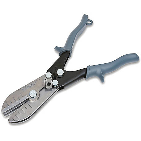

Post by: johnny on January 25, 2020, 03:56:54 PM
i prefer wiss...
posi (https://www.posi-products.com/positite.html)
