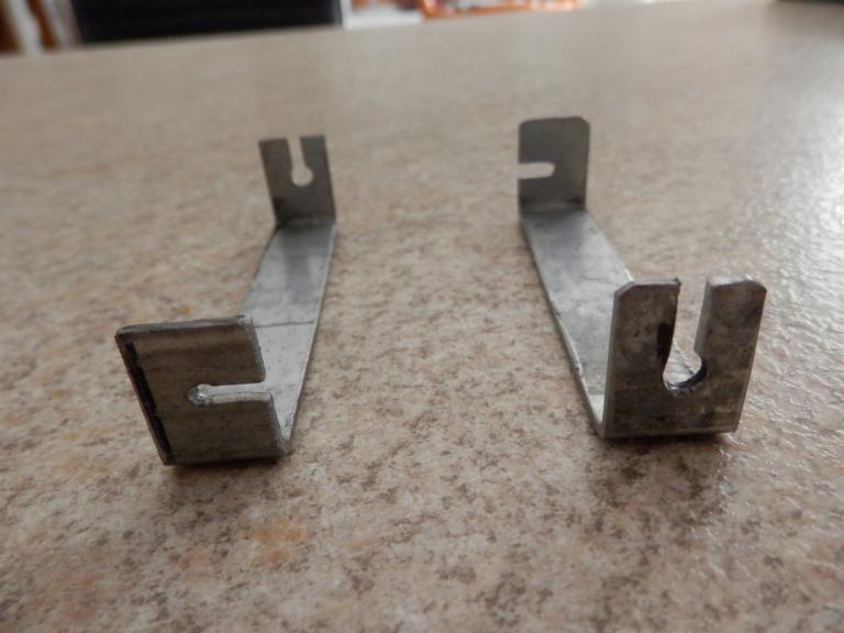

Tills have a clutch adjustment tool to make the whole process even easier. https://www.tills.de/product-140.html I made a homemade one and it definitely works makes it easier and faster.
* Clutch Adjust Tool.png (44.8 kB . 768x576 - viewed 707 times)
I thought about buying that but wasn't sure if it was worth the money. But if you say it's worth it I'll make one the next time I'm at my buddy's place. It looks easy enough to fabricate.

I thought they were a bit of a gimmick but are worthwhile. I made mine out of a piece of 75mm x 50mm rectangular box. I adjust mine as follows unhook the cable then adjust the bolt until it just touches and lock the nut. Fit the adjustment tool and adjust the cable length to suit. Hook the cable back up and then adjust at the lever for the correct free play. I have heard of Gryphs problem with the lever hitting the muffler however I've never had trouble with mine hitting the muffler. I just checked, it clears by 5mm.

Fortunately the bike has had no other issues.
Was the transmission output shaft clipped into the driveshaft's front joint and the shaft needed force to separate it from the output shaft?
Did you find the various clutch cable lengths in the parts fiche and compare their length with the one on your moto? I not convinced you need one though. :-)
Have you inspected the clutch boot for tears?
Do you see that cracked plastic cover on the the rear of the transmission? That should be preventing water from affecting the gear position indicator switch beneath it. If you don't clean the switch and repair the cover, the switch is likely to malfunction if it hasn't already.
(http://www.motobrick.com/gallery/2/1601-030120140903.jpeg)

Gryhon: I was able to pull up the part number of the clutch cable but looking at the cable itself I was not able to actually find any markings whatsoever. That's why I mention measuring it to compare the length to factory spec.
The reason I asked was to confirm that you had the correct cable.  Every BMW cable I have come across has the part number printed on it.  If what you have is an aftermarket copy, there are no guarantees it is the correct length to allow proper clutch adjustment.
I still think you have a transmission issue, probably associated with the dogs for 2nd gear, or the shift forks.
May I ask how much you paid for this bike?  You probably need a replacement transmission.  I see a number of them on eBay for under $200 and many of them have gear position indicator switches that look to be in better condition than yours.  That switch alone in used condition could cost as much as $100 itself.
Let's hope that your clutch is still okay.
Let's have another sound file of the unidentified noise.
Yes it need to be removed with force. A bit more force then I was expecting. I was glad to have removed the swing arm ahead of time so I could get a proper grip and leverage.
I didn't pull the one from my bike yet so haven't had the chance to compare. I'd like to avoid the trouble of having to re-route it under the tank, at least till the weekend.
The boot is in good shape, I used engine degreaser and tissue to clean in the bell housing as best as I could for now. I plan to take apart and give the outside a real deep toothbrush and scrub wash eventually. But for now I the boot appears leak free.
Good to know about the switch, the plastic was had to the touch and on there pretty solidly. But for sure that's gonna have to come off.
Sound file will be in on Sat.
