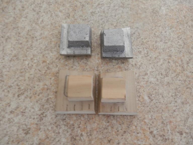

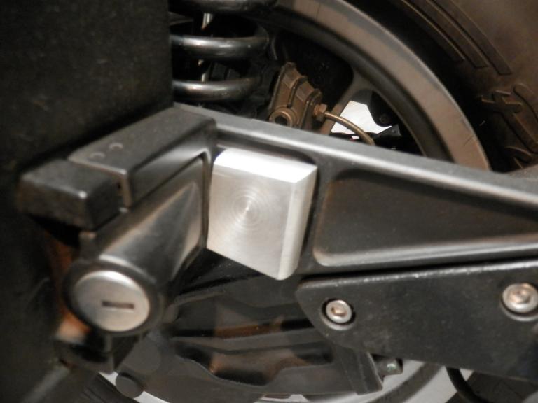

After having my tragkorb come off from kicking it, even though it was locked on. I decided to do a bit of manufacturing to make sure that they can't come off again. After looking at the problem I concluded the best way was to plug the square holes the latches go into.

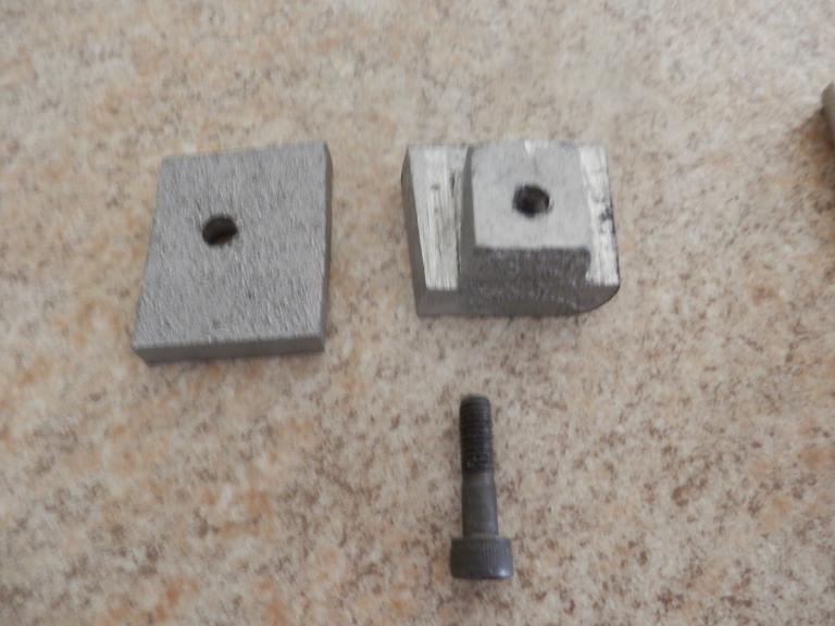

First I made a couple of patterns out of scrap wood and cast them in aluminium at the North Pine Trades Guild. I wasn't happy with the square profile on the corners so ended up rounding them off in the mill and facing with the lathe.
 Now that I have done them it if I did them again I would cast them with the corners rounded. The retainer is held in place with one 6mm Allen bolt. At the moment I'm working out whether to paint them black or leave them as machined.

My rear shock is shot to the point the bump stop has disintegrated. Bottoming out has caused the head of the retainer bolts to rub on the final drive. It would be advisable to fit a bolt with a lower profile head. I just had another look and my foot plate had a bend in it enough for it too touch the final drive. A slight tweak and all is clear.
