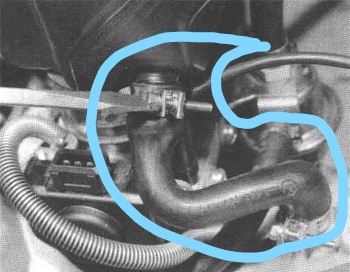

No not that vent port. The Breather Hose. Here :) It's an unlikely culprit in this situation, but considering you got it running and it died out, that hose is a usual place to start.

Lockdown, the hose was flared, fraid anddisconnected at the airbox.  Im working on it now.  That can contribute to an issue certainly.  Thanks for the heads up on it.

Post by: 1ockdown on October 26, 2019, 04:19:06 PM
Definitely get a replacement. You need to order it because you won't get the proper fit from your local auto store. Teflon tape, gasket sealer or whatever creativeness you can come up with is your best friend to seal that hose until you get the replacement so you can keep testing.

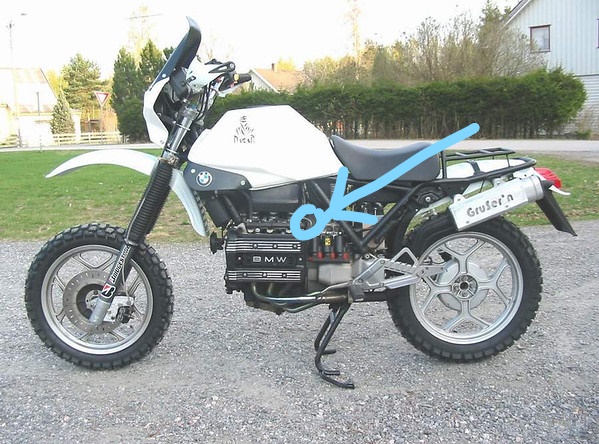

Post by: SDCR john on October 27, 2019, 01:20:53 PM
not trying to hi jack  this thread, but what are the symptoms/ issues that would be exhibited from a bad Breather hose?

I sleeved the breather hose tank connection for the time being.  My local bmw has to order it.

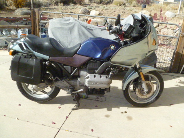

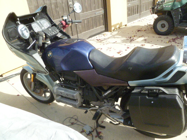

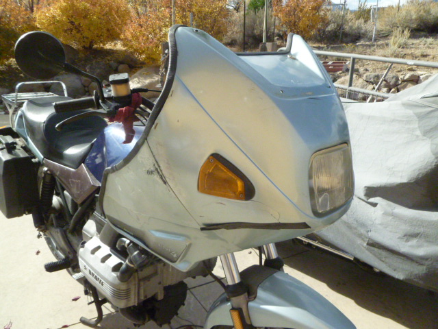

As I am asking these questions, I though I'd share what Im working on.  This 86 was on Craigslist. 52k miles  It was stupid cheap....the former owner just gave up when he heard sprag clutch and the BMW dealer hit him with a quote $$$.
I was going to cafe racer it, but when I did the accounting of parts it was basically all there.  25 years ago, I remember those Pichler Uni 4 fairing were very expensive.  It needs some body work, but that's easy and have the proper paint waiting to be sprayed.  Great paint shop here in Reno.  I was going to pull the package rack but I remember those being expensive in the day.  Anyway thought you guys would like a photo.

Post by: Laitch on October 27, 2019, 02:18:27 PM
The fuel cap is 180º out of rotation. In its correct position, it allows water accumulating around the cap to drain to pavement via a port beneath the right side of the tank that is connect to a port in the cap's flange.

Post by: filmhog on October 27, 2019, 02:27:58 PM
Will fix gas cap orientation today.

Post by: SDCR john on October 27, 2019, 03:30:00 PM
Nice find. What color are you planning to paint it?

Post by: filmhog on October 27, 2019, 04:32:09 PM
Hello John,
Im going to paint it Factory with Paint code 616, the blue you see on the front fairing, fender and rear body section.

Post by: SDCR john on October 27, 2019, 08:08:33 PM
Nice, should look good with that rare Pichler. Hope you are able o fix that Sprag clutch issue. From what I have read, it could be prohibitively expensive, if it has to be repaired.

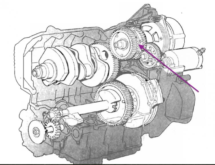

Greetings to the group.  Im going to pursue the hole drilling method of sprag repair.  Please, how do you remove the  airbox base?  When I search for this in this forum and on the net, the results are for people that want to put a k&n filter on not just remove the airbox base.  Is there a better search parameters to use?  At the same time I will replace the oil breather hose.
Title: Re: 86 k75 with sprag clutch issue, need to start it to fix it. Suggestions request
Post by: Martin on November 02, 2019, 06:03:09 PM
To remove the air box base it is possible to get your hand (large and gorilla sized hands need not apply) in there once the air cleaner element has been removed. The base is held in by two Allen bolts which can be removed. Once the bolts have been removed it takes a bit of wangling and wrangling to get the base to come out. A slight bit of force is acceptable. The hard bit is getting it back in as there are two large flat washers that go under the base and the two Allen bolts go through them. I have found that it is much easier to glue them in place to the bottom of the base rather than trying to line them up.
 If you need to remove the top part of the airbox I've found it easier to remove the tank and use a  long screw driver to undo the AFM hose. Getting the hose back on can be done but is time consuming as there is not much room.. Removing the radiator would probably make it easier. If you know someone  mechanically competent with small hands that can be recruited all the better.

Post by: Chaos on November 02, 2019, 06:04:53 PM
parts fiches sometimes help

Post by: Martin on November 02, 2019, 06:47:58 PM
Thanks Chaos, orientating the jubilee clamp #10 so it accessible from above will make life easier in the future. Part # 4 & 5 are a large flat washer on mine which I temporarily glued in place to stop them moving on assembly.
Post by: filmhog on November 02, 2019, 09:59:40 PM
Thanks Chaos.  That is what I needed to know.  Im with you on gluing the washers in place.

I remember that DKW 1000 FWD transmissions had something called "rueda libre" in my native language. The thing was a sprag clutch and would start failing because people would add high pressure additives to the standard gear oil (Molykote comes to mind). The only way to revive the thing was to disassemble the tranny, soak the "rueda libre" in a slurry of very fine valve grinding compound and thin oil, and give it a good workout.
Would it be tooo bad to add a few dabs of an abrasive into this thing, and then flush the tranny several times to avoid contamination?
Post by: Laitch on November 06, 2019, 04:52:32 PM
It isn't in the transmission. It's nested within those gear wheels at the magenta arrow point.
