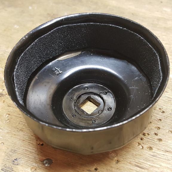

they are iffie at best... i putts skateboard tape inside of mine to gripp the can...
also have one with holes in it so i can run sheetmetal screws in there if the can is stuck...

Post by: johnny on November 04, 2019, 03:18:15 PM
http://www.motobrick.com/index.php/topic,580.msg108596.html#msg108596
* 20190325_101020.jpg (57.04 kB . 576x576 - viewed 455 times)
