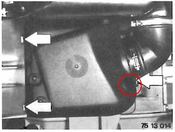

you mean this screw... if so that only affects idle... from full in it shoild be out 4 turns for oe...

once again... is it this screw...
* filterhus.JPG (45.18 kB . 747x562 - viewed 1045 times)
you see... i poasted a photo of a screw when you should have poasted a photo of the screw...
if so it is all way in and 4 turns out for oe...

its all the way in and 4 turns out for oe...
