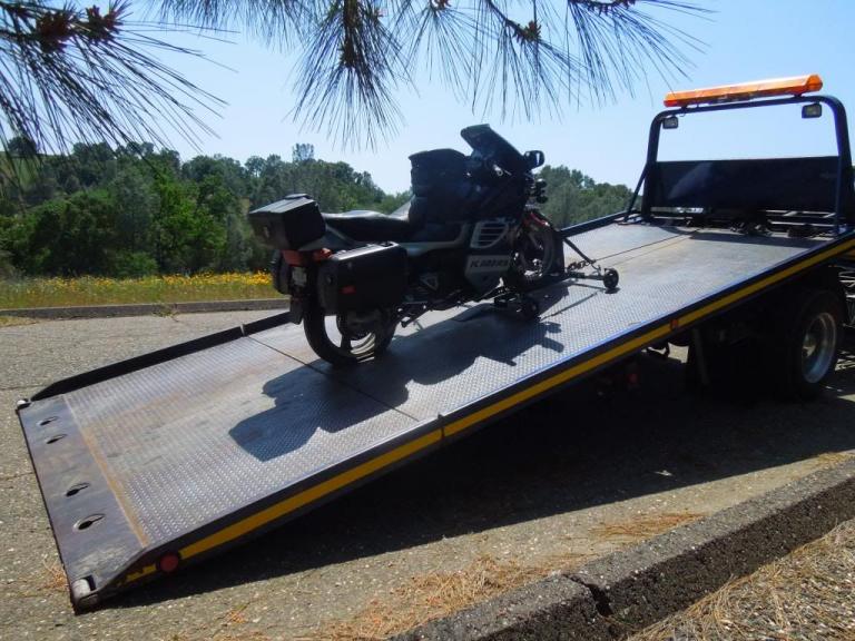

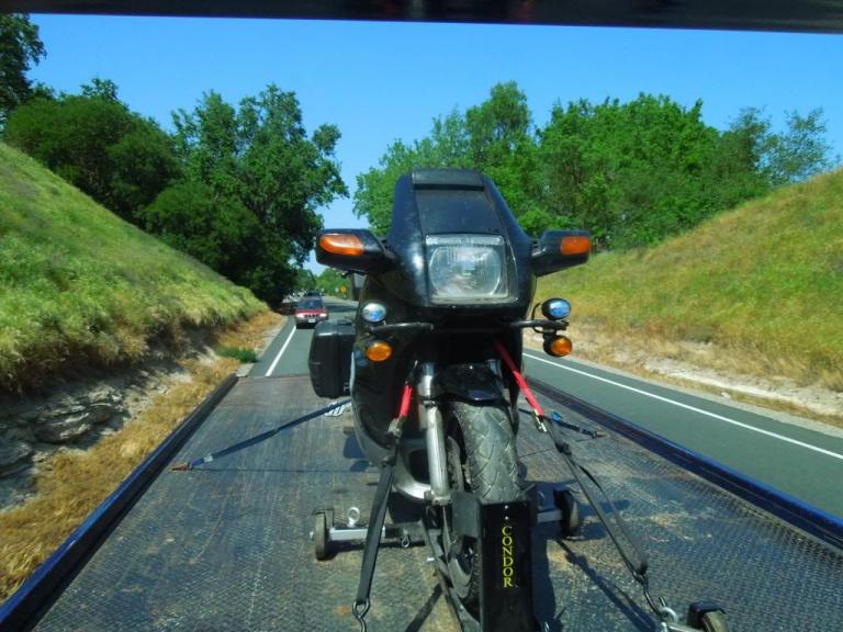

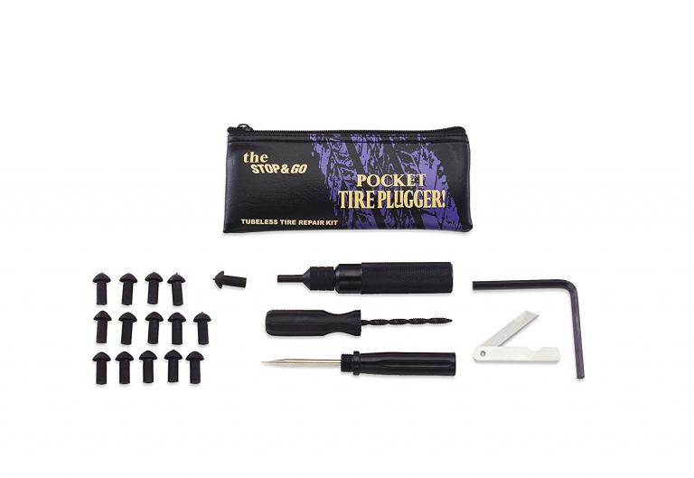

have had 5 moto punctures... only 1 required a call to aaa cause couldnt getts the mushroom or the snakes or both to maintain enough pressure to ride 2 up outta the booonies... the rest of them gotts me to civilization...

for minimal stowage and maximum reaming.... its the...
slime t handle kit... (http://Slime 1034-A)
* slime t handle.jpg (23.48 kB . 400x400 - viewed 408 times)
putts it in a ziplock with extra snakes so it retains its suppleness...
also carry the mushroom stopngo ki (https://www.stopngo.com/pocket-tire-plugger-for-all-tubeless-tires/)t...
* stopngo.jpg (26.28 kB . 768x529 - viewed 453 times)

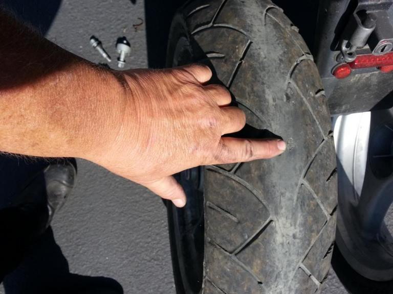

sticky snakes alone or mushrooms alone were a no go on this one... took 1 mushroom 2 sticky snakes to gotts us hunderts of miles down the road...
* 3mushrooms.jpg (57.51 kB . 768x576 - viewed 498 times)
* 20190817_103728.jpg (78.43 kB . 576x576 - viewed 451 times)
* 20190817_104142.jpg (62.05 kB . 576x576 - viewed 434 times)

I've carried on my Vespa one of the Stop and Go plug kit that I bought from Aerostich 14 years ago and after nearly 60 thousand scooter miles haven't needed it.  Have been wondering whether to put it with the K75.

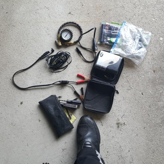

i have a ase to powerlet for easy power to the pump... also carry powerlet to ase to gater clips to jump a low battery moto if the need arises... which it has... the k75 can easily flood when hungover and battery drain is usually a byproduct... can go powerlet to powerlet for a boost or powerlet to battery for a charge...

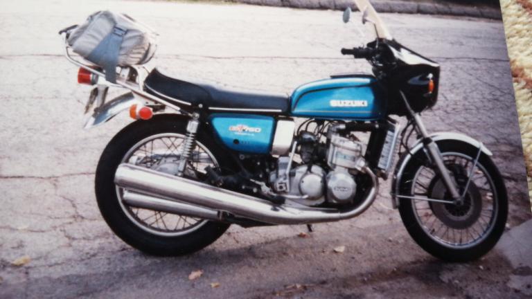

I've only had 2 flat tires in 40 plus years, one  was on a '76 water buffalo, about 1 mile from home, at the end of a ride, front tire, got home slowly with no drama.  The other was on my k75, rear tire, i bounced it off center stand in the garage and i couldn't roll it backwards, it felt like the brakes were on.  Quickly figured it out and reshod both ends.  It occurred to me, some may not know 2 stroke slang for the Suzuki, gt750 aka a water buffalo, liquid cooled triple.  So here's a pic.
* '76 water buff-002.jpg (49.24 kB . 768x432 - viewed 514 times)
